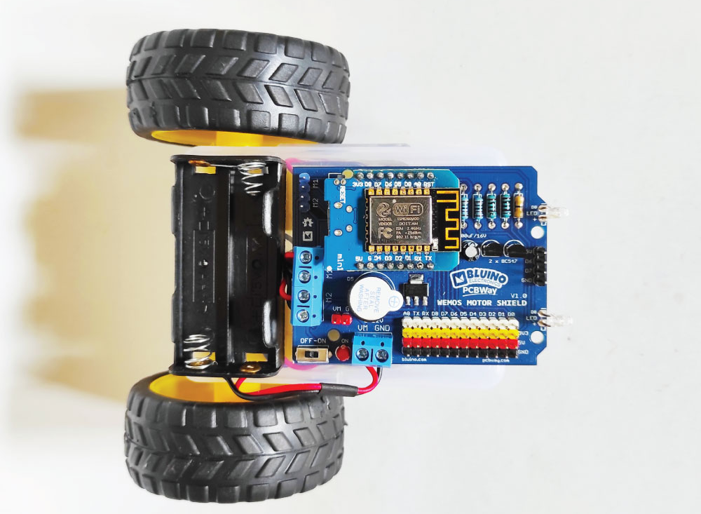

If you want to make a Weemos motor shield later, you can consider this:
