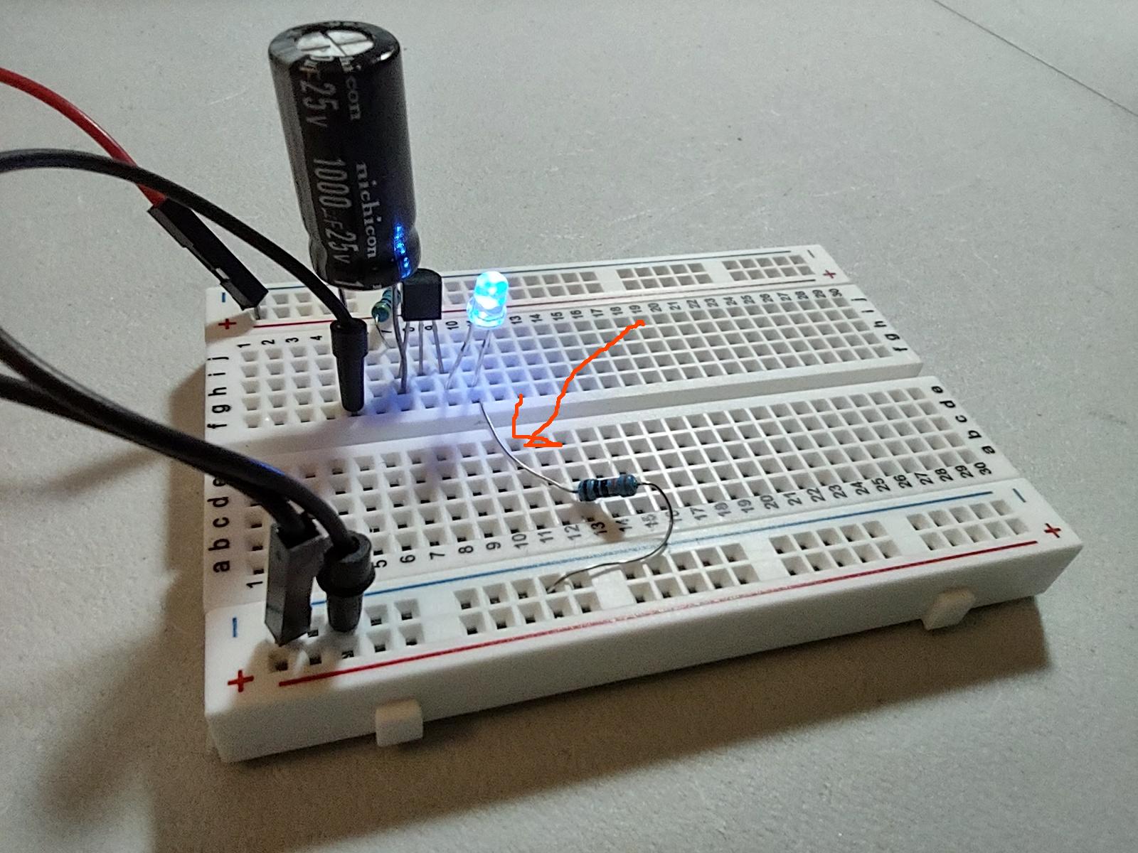

Well, I actually got one of the new 2N2222s to work. But it's really weird how it's doing it. Quoting myself,
Tonight when I was just trying the new 2N22s they would light up a like before but not blink. But then suddenly it did for a short time so I kept messing with it. I found that if I touch the wire between the cathode of the LED and the closest side of the 330ohm resister it will blink.
Here are some images. I took a video of me touching the wire but I can't seem to upload it. Where the red arrow is on the third image is where I touch and it blinks.
I do not see anything connected to the middle transistor lead, and that should be the BASE terminal!
Try cutting off the base lead at the transistor body and use two 9v batteries to give 18v for the power supply.
Try placing the capacitor across the Emitter to Collector.

There isn't anything connected to the middle wire, watch the videos.

Try a RED LED, drop 1.7V
Blue 3V0 or higher.
The volt drop may have an effect.
I just tried other color LEDs, red, yellow, green and white. White works. It's blinking on its own. Finally.

That circuit doesn’t make sense.
2n2222 is npn bjt. As per mentioned circuit emitter is connected to +vcc ( arrow pointing out )and collector to ground. Diode cathode is connected to gnd via resistor which is ok but as per bjt arrow in schematic diode is reverse biased and cant pass any current thru it. Besides that base is not connected to anything

I lowered the LED resistor from 330 to 150 and now I can get all the colors, R, B, G, Y and W to blink.

What I gather from this is: With enough voltage applied, the reverse biased base - emitter junction will conduct (as a zener diode would) and simulate a flow of base current and then a current can flow backwards between emitter and collector (as a PNP transistor). that can light the LED and discharge the capacitor to below the conduction voltage, thus forming a relaxation oscillator. Very interesting!

Fastlad and circuitlab simulation with 2n2222 doesnt prove that this can work. Actually its exact opposite this circuit can work only if collector and emitter are shorted internally in bjt. Can someone make this corcuit work in simulator? Even in its at vebo breakdown all the time it doesnt mean that this is right way to make a flasher. Same way we can make a heater from almost any ic :-)))))
That is a typical circuit for a unijunction transistor oscillator, but I do not see how a reversed NPN can work, even if some say it does. Not that I doubt it, since I haven't tried it. I just cannot explain it.
