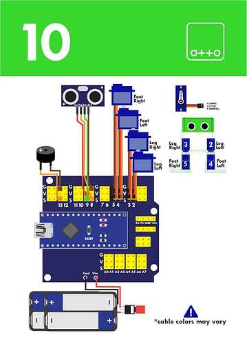

I am doing a project with arduino nano and nano shield using 4 servo motors, 1 HC-06, 1 buzzer. I send and receive commands from the phone via Bluetooth, but whenever I use servo motors, the Bluetooth connection is disconnected. I am using 4 pcs 1.5V pen batteries. What must i do?

Start by posting your code, using code tags when you do, and a schematic of your project. a 'photo of a hand drawn schematic is good enough
Hi, @nemes1s
Welcome to the forum.
Do you have a DMM?
Please include ALL hardware, component names and pin labels.
What are the servos moving and can you post link to specs/data on them?
Thanks.. Tom..

With a DMM measure the battery volts and make the fault occur.
Did the battery volts drop?
What spec your servos?
Tom...
PS. The image you supplied is OK, but you need to draw actual electronic schematics to make a diagram that can be easily followed for trouble-shooting.
Your post implies that your project works until the servos are actuated, i.e. it receives a command via Bluetooth OK, but Bluetooth then dies. If so, this suggests an inadequate power supply. No amount of re-drawing is going to fix that, but you might enlighten us on the actual batteries and the ratings of the servos.
Barely adequate! You might need to provide a separate power supply for the servos.
My power supply is:
LR6 AA 1.5 volt alkaline pen battery x 4
Others:
Tower Pro SC90 Micro Servo x 4
HC-06 x 1
Buzzer x 1
HC SR04 x 1
Nothing in your reply answers the questions. Try disconnecting the servos and see if Bluetooth keeps going.
If it does, that is further confirmation of inadequate power.
You appear to have a servo shield specifically made for Nano. If so, you might check if it can run with 6xAA, i.e does it have on-board regulators?
