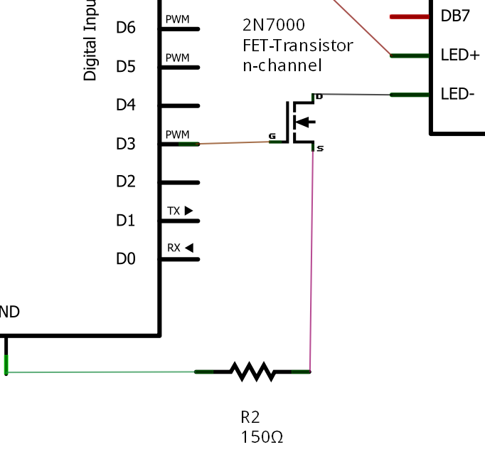

I'm back, trying to get more power to the dimmest LCDs.
The 150 ohm resistor in serial with the pwm works nicely, but I would want to try to use a MOSFET to get more juice to the LCD backlight.
I have a 2N7000 available and wished to use it.
Could you just tell me if this is the right way to do it ?
As I already said, I'm a beginner in electronics and I'm afraid to make some stupid choice which would fry the arduino or the lcd (or both !).
Exactly what I needed, Thank you !
Side note : It seems "Justin Berken" use the wrong symbol on his diagram (p-channel instead of n-channel), but judging from the datasheet of his MOSFET, it's a n-channel as my 2N7000.
