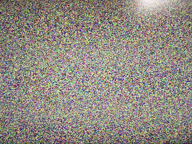

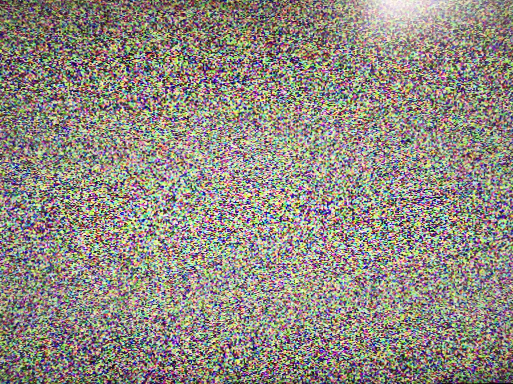

@DarioPennisi If i unconnect / reconnect the display and double tap reset i get this. (See attachment) Pixel garbage
This looks really weird. Have you any chance to try a different monitor? Have you ever seen the Arduino logo at boot? I don't think the image comes from the board; more likely that monitor is thinking we output hdcp while for sure we don't...

No. I have never seen any output at the HDMI port. Thats why I started this thread (topic) in the first place.
ok. let me know if you don't manage to get any output. it may as well be an hardware issue on your board, in which case please contact service and you'll get a replacement.
