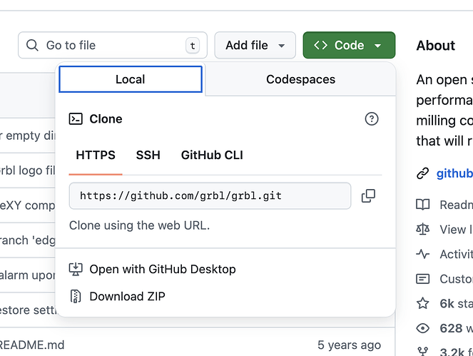

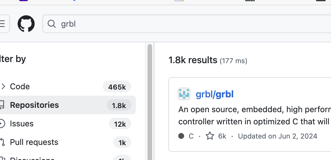

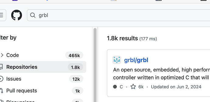

First get the zi file from git. I am just showing screen grabs of the steps, reply if you get stuck but this works. First goto github and enter grbl in the search box. Click on the first entry grbl/grbl
Click the green code button
Now click the Download ZIP

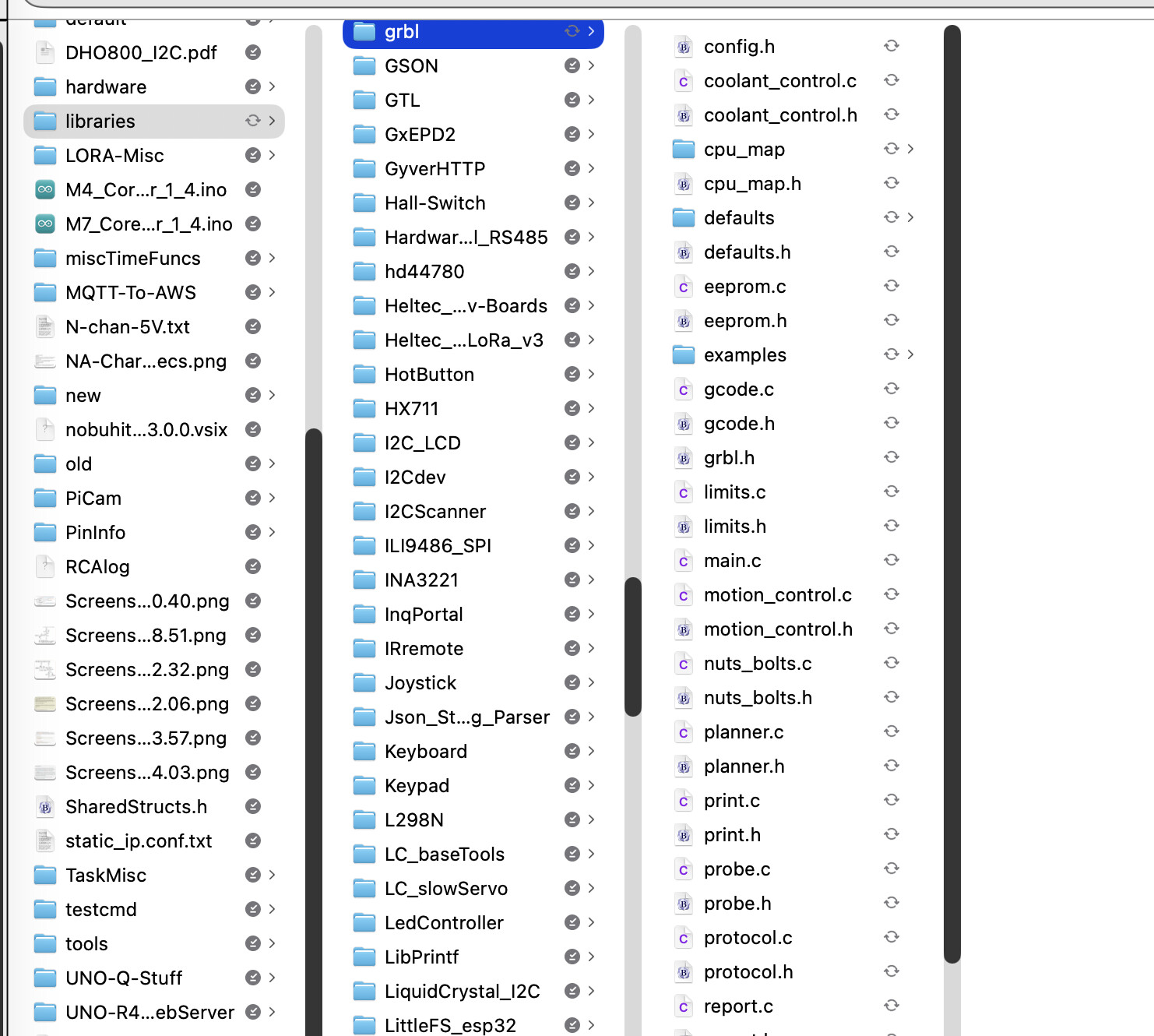

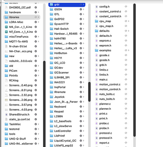

Now copy the grbl folder under the grbl-master folder that the unzip created
Now paste the grbl folder into your personal libraries folder
DONE

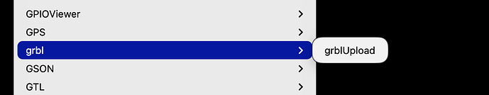

You probably need to re-start the IDE and when you do check the list of File/Examples and grbl will be there
