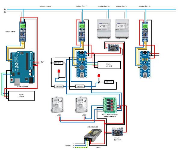

Help creating a Modbus slave
Hi
Need help whit creating a Modbus slave that sends data in same way as a SDM630 Energy meter.
I have tried a lot of different things and read a lot of things on the net but i cant crack this one on my self.
Status:
  • My layout is as the attached file, layoute_Modbus_SDM630_KAM382.JPG.
  • I can read and print (Serial monitor) values from the two SDM630 (Slav ID:1 and 2) on the Master Arduino (UNO)
  • I can read pulses from KAM382 and calculate power values on the Slav Arduino (Nano), Slav ID:3.
  • I can write/read KAM382 power values to/on a LCD display and to/in the serial monitor, on the Nano.
What to achieve:
Now I want to send the values from Nano (Modbus slave ID:3) to Modbus Master (Uno) in the same format as the SDM630 uses to send its values over Modbus.
Why? So i can use the same Modbus Master for SDM630 and other non Modbus energy meters. In my case two Kamstrup 382.
SDM630 using IEEE 754 format floating-point number, see attached file, Easton Modbus Registers.pdf.
What do i need help whit?
  • Making modifications to my slave sketch, Slave_KAM382.ino, so it can send the power values from the 2x KAM382 to the Modbus Master (Arduino/Uno).
  • Point out which ModbusSlave library to use and help to modify it if needed.
  • All other good modifications on the code
The ZIP file contains sketches and library and some photos.
Regareds // Vind89
Eastron Modbus Registers.pdf (283 KB)
Modbus_SDM630_Kam382.zip (337 KB)

Thanks for the reply.
About the registers:
  • Yes, for the moment I'm just interested of the two registers.
About the library:
I have tried that one and i didn't make it work. I think maybe i tried to hard and maybe made it to complex. I will try again and see if i can get it working. I will come back whit some modified sketch for you to look at.
About serial:
I will follow your recommendation and use the hardware serial for Modbus.
About the drawbacks:
I will remove those and see if its still runs good. If it does those lines will stay in the trash bin :slight_smile:
Some small questions on the road:
If a have the value of say 9560.34 or -1223.23 and want to send it. How to get it in the IEEE 754 format.
What i can see the ordinary Modbus RTU is 16 bit and 754 is 32 bit. 754 need then two address fields.
How do i convert the values it and how to put it in to two address fields 0x0000 and 0x0001 for 9560.34 and 0x0002 and 0x0003 for -1223.23?
// Vind89

  • Use Control Structure "for" to reduce the amount of code.
Next step is to:
  • Implement WiFi on the Uno.
  • Send data to KepServerEX
  • Publish data on a WEB page.
A little heads up about this line:
LiquidCrystal_I2C lcd(0x3f, 2, 1, 0, 4, 5, 6, 7, 3, POSITIVE);
Bee aware that the address "0x3f" could be different between LCD displays of the same type. I had one with the address 0x3f (Slave ID:3) and one with 0x27 (Slave ID:4). Very time consuming.
Thanks all for the support.
All files is attached down below.
// Vind
