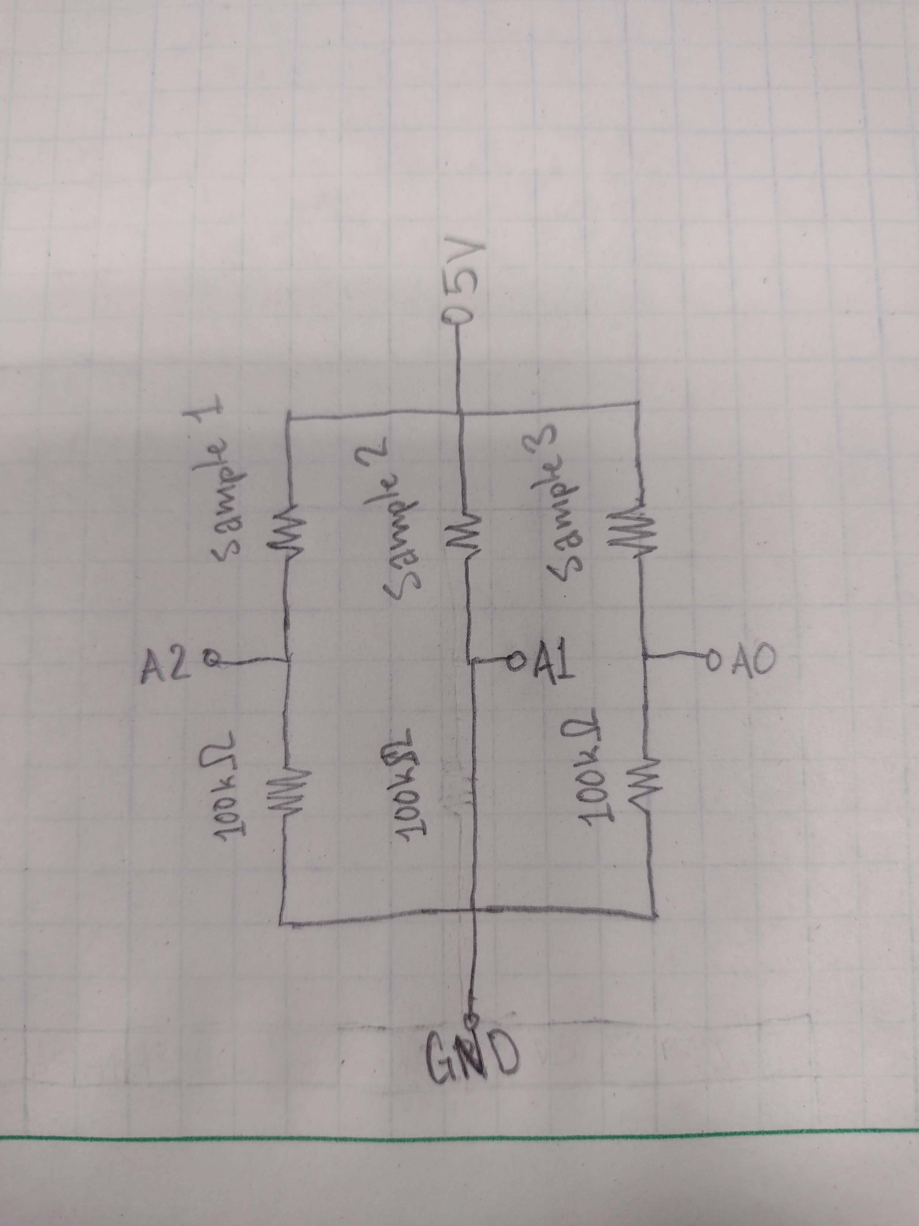

I am attempting to measure 3 individual resistors with one Arduino. I have been able to successfully use a simplified version of the code below to measure a resistor when using two electrodes, but I am getting "phantom" resistor readings with the current setup that I have. I have attached images of the phantom readings, both of when I have the wiring set up as a breadboard and as DuPont connectors. I have also connected just the image of the breadboard wiring (due to having a limit of 3 images that can be uploaded). What indicates to me that this is a wiring and not a code issue is that when I used Tinkercad to create the circuit on a breadboard, it worked how I intended. I'm at a loss for where these "phantom" readings are being introduced, any help would be greatly appreciated.

Above is an image of the theory of how this is supposed to work with a single analog pin (my resistors are 100kOhms, not 117kOhms). I am attempting to measure the resistance of a membrane, with two electrodes on each side, one of which is the power supply and the other 3 are sensors. I have left the 5V unconnected as I am trying to do preliminary testing to ensure that the wiring works before connecting the entire system to measure the membrane resistance. The 5V will eventually be connected through an imaginary 4th resistor, i.e., the membrane. The image below should illustrate my goal, I am just at the "testing each electrode individually" stage before proceeding to that point.
goal
Imagine E1 as the 5V, with E2, E3, and E4 as A0, A1, and A2, respectively. My goal is to measure some R_m, with R_1 and R_3 the resistor in line with A0, R_1, R_3, and R_4 as the resistor in line with A1, and R_1, R_3, and R_2 as the resistor in line with A2. Hopefully that makes sense as to why it's not connected and why I need to isolate the "phantom" readings when the 5V isn't connected to anything.
Hi, @jmd036
Indicating where you are disconnecting the 5V.
Are you aware that without the 5V connected, you will have no current flowing through your resistor network, so no voltdrop to measure across the resistors.
This might help.
What do you expect to get with no 5V supply connected to your network?
I am splitting the 5V power supply, then measuring the voltage drop at the analog pins, then relating that to the voltage drop to 0 at ground across a known resistor for each parallel.
When I have no power going to the system (i.e., the 5V not connected), I expect to see "inf;inf;inf" as the output.

The A0, A1, A2 readings. When R2, R3, and R4 are calculated then printed in the void loop with nothing connected, they should output "inf," basically saying that there is a divide by zero error because there is no voltage drop.

You are loading your divider circuit with the input impedance of the A/D. This is swamping your input circuit. Put a 100 nF on that point and give it time to charge. The reason is when the A/D samples it draws a finite amount of current from its input.
These are due to the PCB construction material, soldering residues, external wiring, integrated die problems, contaminants, non ideal components (ex. capacitors) etc.
You cannot do much about the I.C. die.
My apologies for not understanding, but could you explain this to me? I don't know what A/D is, and I'm unsure of what "swamping" a circuit means.
To clarify the one thing I think I understand, do you mean put a 100nF capacitor between the 5V source and the split of the circuit into parallels and add a longer delay to the void loop startup?
The cap would be between A0 and ground. The A/D (Analog to Digital converter), is part of the chip that converts the analog input to a digital value does not have an infinite (does not have any) resistance therefore it does have resistance(impedance). Therefore that resistance is applied parallel to your input circuit. You could also place an Op-Amp in the input circuit set up as unity gain to eliminate the A0 loading. Schematic shown below. You will need to be careful of your choice as not all op-amps will swing rail to rail.

What @gilshultz suggests is certainly worth considering. However, I'd also suggest working with a more stable reference voltage instead if the 5V supply voltage. You could e.g. use the internal 1.1V reference on the Arduino, or a dedicated and stable external reference which you apply to the Arduino's Aref.
Using the 5V supply voltage as a reference works well enough if "close enough for government work" is OK. However, if you want to squeeze the last bit of resolution from the A/D (analog/digital) converter, it's a good idea to work with a stable analog reference - and also to spend attention on circuit layout, and in particular grounding. Currents through your ground wires can create small potential differences between the GND of your DUT (device under test) and the Arduino (i.e. the ADC). These add up/subtract from your ADC measurements.
  • Try reading the analog input, throw that reading away, read the same input again and keep that reading, etc.
  • 100nF capacitor on each analog input to GND.
  • Lower the 100k resistor 10k .
  • As mentioned, leakage currents can prevent accurate readings.

I made an incorrect assumption when trying to validate each individual analog pin reading. I assumed the wild fluctuations would persist when the additional resistors were installed, making every reading fluctuate wildly, but I installed 3 resistors and it worked fine. I guess it just means that while the actual sample "resistors" are not being measured, the device will give wild readings, but will stabilize when it is inserted into the sample.
