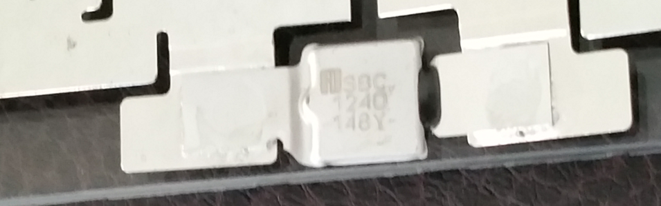

Help identifying this diode, it is embedded on a solar array.
Hello, I purchase some solar cells and they came with diodes on them. I believe they are bypass diodes. The seller knew nothing about them.
I don't have a part number or a brand name. I believe they are sunpower, but that's all. I have attached two photos showing the diode and the diode number.
Can some one help me identify this diode or tell me a equivalent diode that I can use?

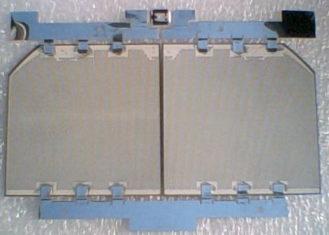

Thirs photo is the back of the two cell array with diode on the top center.

The panels already have the diodes on them - why do you want to know?
Well, they will be either bypass diodes or series diodes - the first is to maintain function of a series array if the particular panel is shadowed, and the second is to maintain function of a parallel array if the particular panel is shadowed by preventing it absorbing power.
In any case, it will generally be a Schottky diode rated for at least the same current and voltage as the array.

Oh, ok. So, each cell (there are two cells in the pic, diode is on the top center bus bar) outputs 0.56v @ ~1ampish and there is two connected in series on every array. Look at the photo I attached to see where the diode is located. The pic is from the back of the cells. I want attach 6 of these in series and add a diode just like in each. Hope I'm clear about it.
I've never seen solar cells organized this way. Where the diode is now doesn't make any sense to me.

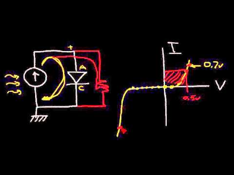

Two types of diodes are used in solar arrays. Blocking diodes and bypass diodes.
One blocking diode for the whole array, and one bypass diode per one, two, or more cells.
When one cell is shaded, e.g. when a leaf falls on one cell, the cell does not generate power anymore, but starts to use power. It could melt, and start a fire.
A bypass diode prevents that by shorting the reverse voltage of the cell.

Here is a Youtube video that explains what I meant to say.
Leo..

If each array produces 1.12v @ 1ampish and I want to connect 6 arrays in series, what sort of bypassing diode in between the arrays do you suggest me to use? Total open voltage would be ~6v @ ~1amp.
Each array already has it's diode, but are not manufactured to connect them in series, thus no diodes included in between each array.
For instance, if I connect first array with a second array, there would be missing one bypass diode in between the two arrays.

Well, as painful as it was to detach a diode from the power bus, I did.
I then measure it with my multimeter and it read 0.111 and OL. I also measured the resistance and it read 512 kohms and OL.
My diodes I ordered are still on their way. I'll post updates, thanks all for replying.
Pringles:
0.111 indicates a Schottky - as one might expect. The resistance value is completely meaningless since it is not a resistor. :roll_eyes:
