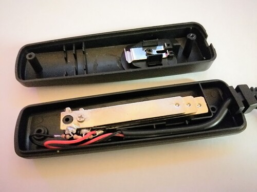

Hi, I was wondering if I could get a little help here.
I want to trigger my camera via a microswitch on my 3D printer, here is the diagram for the stock DSLR trigger for my make of camera, but I really only need the "shutter" switch and the "Focus" part omitted.
Would this just be a case of connecting the - directly to the one node of the switch, and the other node of the switch in series 2K2 as a pullup resistor to the +

No, not when settings are on manul, how I use it.
But with the trigger I have yes, even in manual mode. I think this is due to how the trigger is built, its 3 sprung sheets of metal on top of each other, so when you half-press the first two make contact and this focuses, then when you push all the way on the button all 3 sheets connect and it triggers the shutter.
So I have no need for the focus part, and just want to build a simple trigger switch.

The circuit in the first image in the opening post forms a voltage divider; replace the 36k and 2k9 by one resistor of 39k. and keep the 2k2 in place.
sterretje:
Thanks, sterretje!
It works like a charm!
