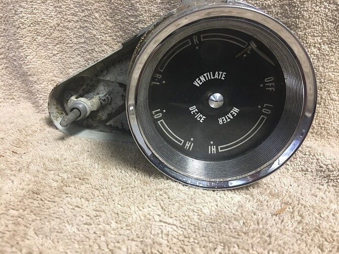

Your getting warm…………….that one has A/C , my car is no A/C, here it is:

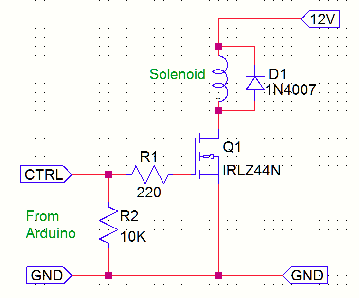

This is the schematic for the solenoids

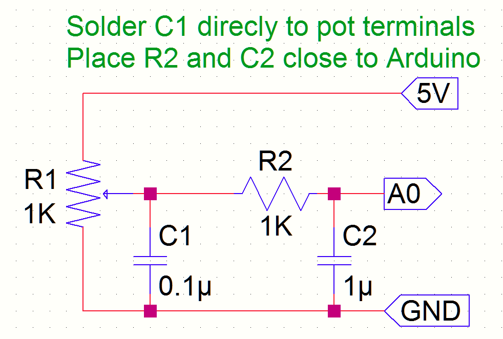

For the pot:

Hi, @wcw858
Have you checked that the valve solenoid you want to control with PWM, is suitable for PWM operation?
Yes I have a rated valve for that.
