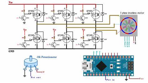

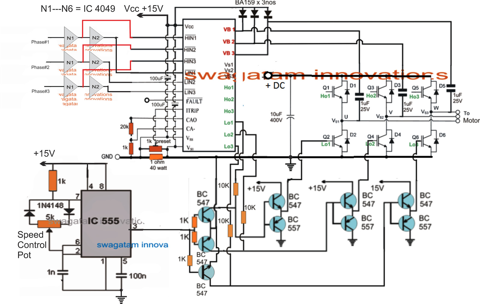

What happened when you tried to find out how to build an ESC?
Do you mean brushless?
A coreless brushed motor is just a DC motor in the end, and standard PWM driven transistors or MOSFETs are your solution.

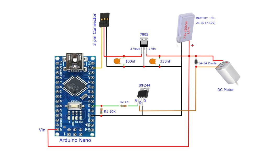

The term "ESC" is a term used for the electronic control for a brushless motor.
If you need a control for a brush motor it can be a simple transistor (or better a MOSFET) controlled by the Arduino "analogOutput" (which is actually PWM)
