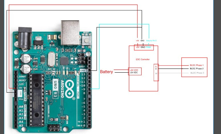

I created a simple program to control theESC according to the servo. However upon connecting and running the program as recommended in the tutorial it did not work. The motor kept running at full speed regardless of the PWM signal from the driver.
Can someone please reccomend any solution or if there is any other better way to control BLDC motor with Arduino.
Motor Connection :
Arduino Code :

Unfortunately that video doesn't say what ESC was used.
I think that controller is a different type, there is no indication it will work with a PWM/servo signal.

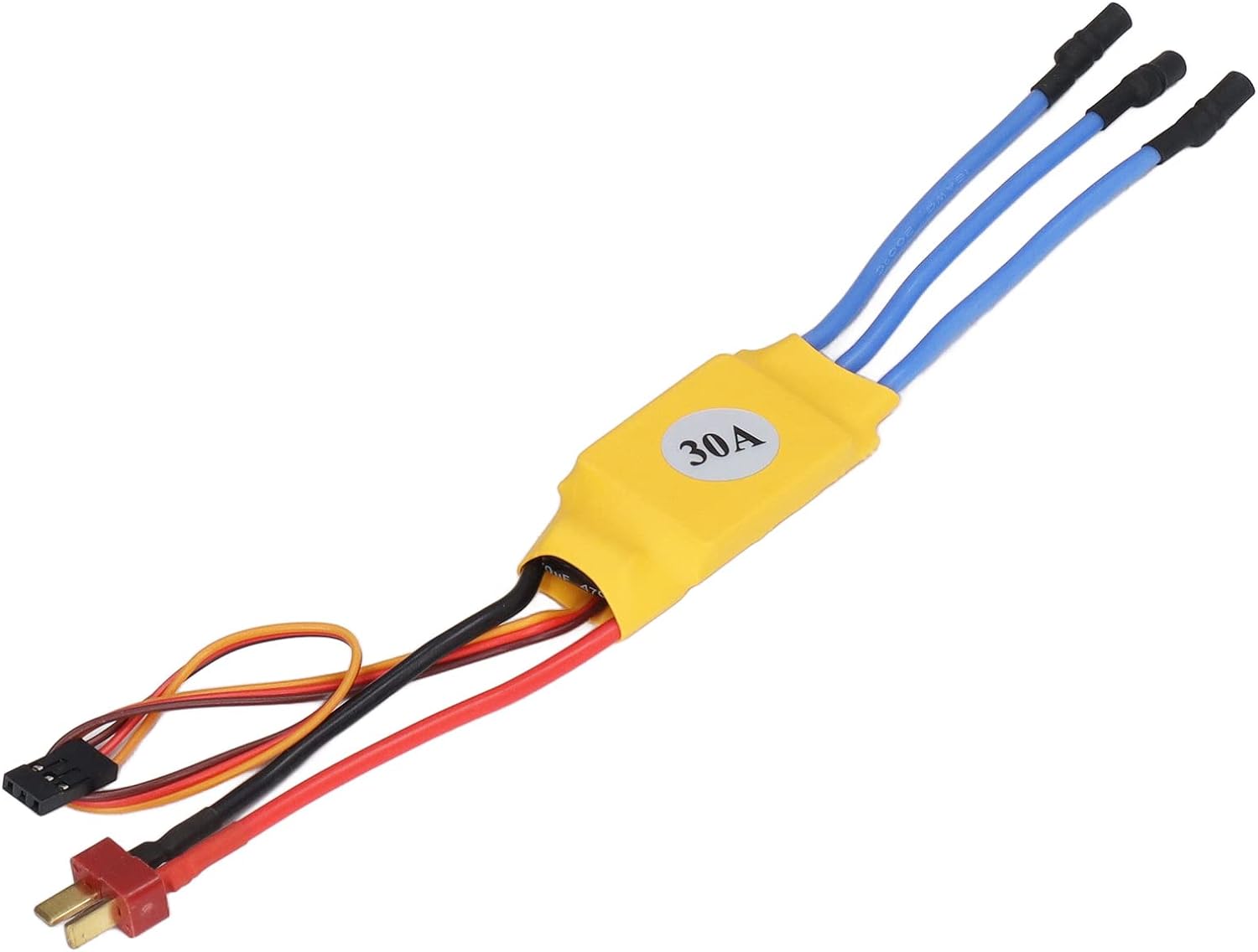

I think the one you want is this one :
https://www.amazon.co.uk/Brushless-Protections-Throttle-Adaptation-Controller/dp/B0BJLCV2WJ
Hi Unfortunately this one is rated for 6-14 V and I faced the same issue where I could not find the same for 24V
This one can deal with a 6S lipo (24V)
