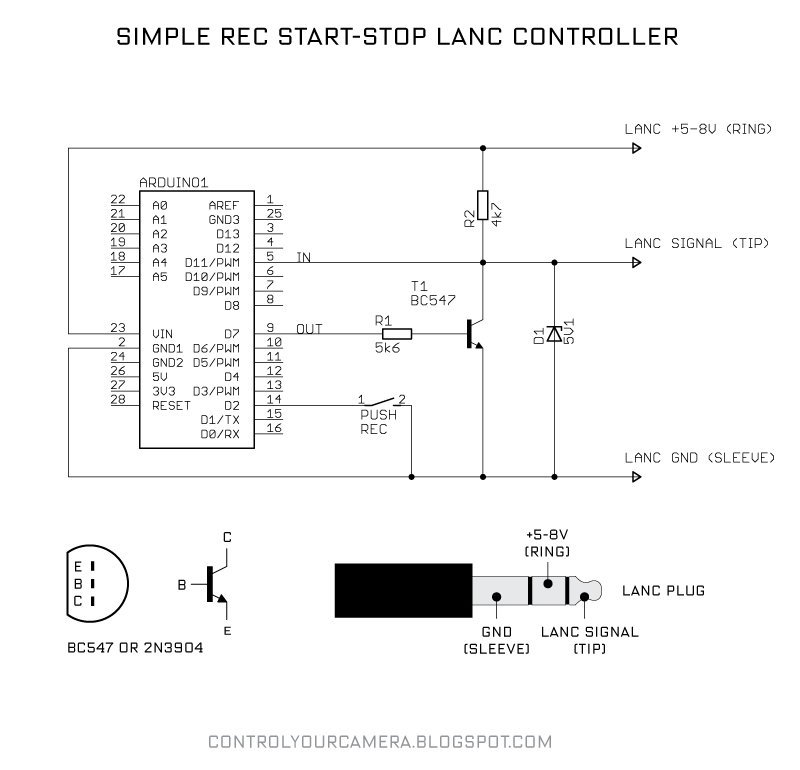

I have a little more to add in case it is the circuit which is the problem for the esp32. This is the circuit diagram I am using. I only have a meter but the Camera Lanc cable seems to only have a floating 2v approx output between the Lanc pin and gnd perhaps this is the problem since the circuit seems to expect 5-8v from the camera lanc pin.

You should post a handdrawn timing diagram how the 0V / 5V pulses look like.
please add information
where did you connect the black-probe of your digital multimeter to ?
where did you connect the red probe of your digital multimeter to?
Best thing would be to draw this inside the circuitry that you posted.
Ok I think I have solved the problem I originally posed. The issue was not with PulseIn which seems to be working fine know that I have switched to another pin on the ESP32!
For those who do not now 'Lanc' Lanc is a rather old but still used camera control protocol invented by Sony allowing you to remotely control a video camera using a three wire cable shown on the diagram. It is still useful when tethering cameras to Pan Tilt heads and motion control systems when you want to control Zoom Focus Iris etc from the PTZ head which is what I am doing. While I think I have solved the original problem unfortunately the camera is not responding to the 'Lanc' commands which may be another timing issue.
I will report back hear if I get any further forward with this.
