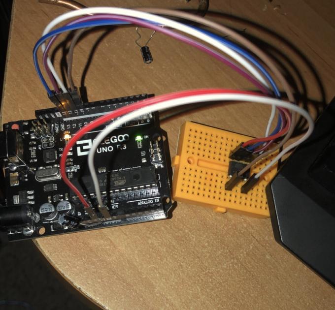

Hi, I am the biggest noob regarding all this type of stuff. I am trying to use an arduino uno to upload code to an attiny 85. I have triple checked everything and replaced all the parts to no avail. I progress until I try to burn the bootloader, then I get this error message:
Arduino: 1.8.13 (Windows 10), Board: "ATtiny25/45/85, ATtiny85, Internal 8 MHz"
C:\Users\andrew\AppData\Local\Arduino15\packages\arduino\tools\avrdude\6.3.0-arduino17/bin/avrdude -CC:\Users\andrew\AppData\Local\Arduino15\packages\arduino\tools\avrdude\6.3.0-arduino17/etc/avrdude.conf -v -v -v -v -pattiny85 -cstk500v1 -PCOM9 -b19200 -e -Uefuse:w:0xff:m -Uhfuse:w:0xdf:m -Ulfuse:w:0xe2:m

Heres a picture of the wiring
Thanks for your help!
update: I didnt have the USB plugged in correctly, here is the error message I have normally been getting - Arduino: 1.8.13 (Windows 10), Board: "ATtiny25/45/85, ATtiny85, Internal 8 MHz"

avrdude: ser_recv(): programmer is not responding
avrdude: stk500_getsync() attempt 1 of 10: not in sync: resp=0x03

avrdude: stk500_getsync() attempt 10 of 10: not in sync: resp=0x03
avrdude done. Thank you.
Error while burning bootloader.
Make sure you uploaded the File > Examples > 11.ArduinoISP > ArduinoISP sketch to the Uno.
