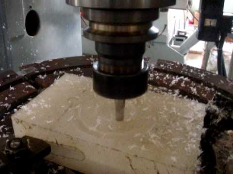

Hexapod/tripod cnc
The title says it all...
In case you don't know what I am talking about have a look here:
In theory this type of CNC mill has some advantages over a more typical XYZ setup.
What is more, there are programs, such as emc2 that can be used to control it (even the 6 axis version)
My question is - has anyone ever attempted to build one based on arduino and succeed ?
It's certainly a challenge without a floating-point unit. However you could easily use the Arduino to talk to the stepper motor controllers and get a host PC to crunch the geometry...
The tripod is vastly easier to do as the geometry involves +,-,*,/ and square-roots - there is an algorithm for integer square roots that's not too cpu-heavy and there may be some digital differential analyser techniques to help.
