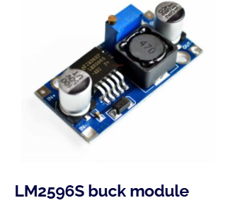

2.Buck convertors (from hobby shops) is mainly around 24V to 35V max Input.
Works very good on 24V to 28V(charged batt).

They are all around 30Vmax Input.
You can certainly use the LM2596 to go from 24V to 9V. However those adjustable regulators are designed so that they work over a broad range of voltages and currents and probably have poor regulation performance at low currents like 100mA but if it's all you have.
