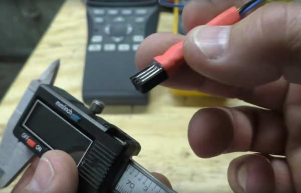

You can easily interface an Arduino to one of the cheap digital calipers:
How well suited calipers are to measuring the thickness of a container would depend on the shape of the container.
Mechanical measurement, such as those digital calipers, is the only way that would work for any solid material.
Other solutions could include ultrasound, capacitive, conductive, or even other methods - those all depend on the material measured whether they work in the first place, and require calibration for each different material.
