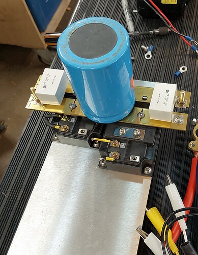

Can you please post a schematic of the assembly in the image you posted in post#1.

This is what I have built so far. I can turn power on and off to my little test motor.
The person who I got the idea from is here:. I altered things some, based on another bit of reading I did (using slightly different IGBTs, based on availability). MaGuire has a controller board design available, and I even downloaded it and had some prototype boards made for cheap in Hong Kong... but when they came, they needed the little teeny tiny board components, and there was no way I was going to be able to solder them in. So I went looking for another solution.
Which brings me here.
Your "circuit does not make sense, what is the need for the right hand IGBT in the circuit?
If you turn it ON, it will short the motor, if both are truned ON you short the battery.
Where is your fuse in the battery line to protect yourself and the hardware?

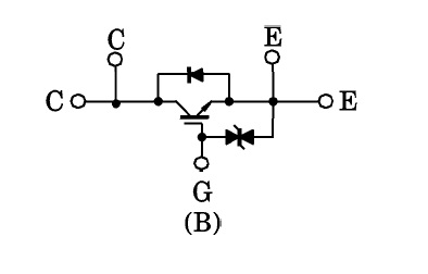

PLEASE use circuit symbols, here is the IGBT symbol in the data sheet.
igbt
This can all fail dramatically without some proper troubleshooting tools and a proper schematic is essential.
PS. Please define "Huge Capacitors", they should be in your schematic.
Here is my interpretation of your project.
Q2 will control your speed, but what will Q1 do when it is turned ON.
I can see you might be using it as a dynamic break, but the IGBT will not just have to withstand the braking current from the motor, BUT the fully charged capacitors.
The motor will have some maximum current when breaking, BUT the capacitors will want to dump ALL their energy at once through Q1.
You will have to throttle Q1 very carefully when operating it.
In fact you are going to need some current monitoring components to prevent things like motor burn out or shorting.
As I mentioned earlier you will need a gate driver IC to control the gates.
Have you done any calculations on these currents?

Q1 is intended for use as a freewheeling diode. The place I got the idea is here.
I have not done calculations on the currents.
The motor will be attached to a manual gearbox.
