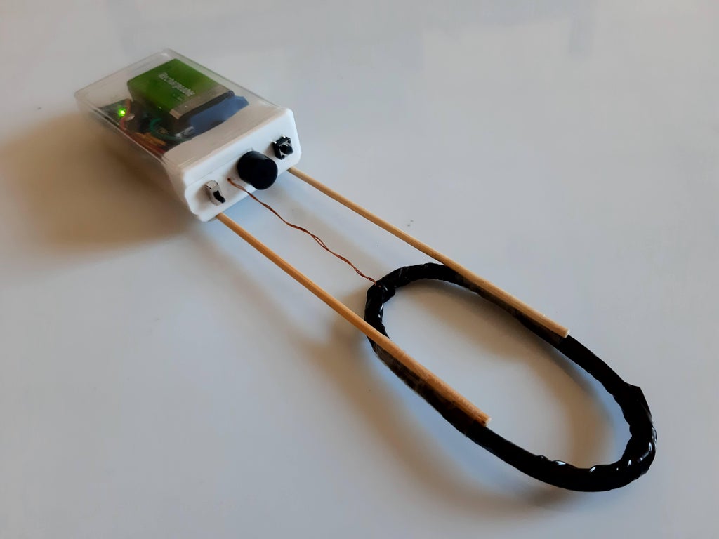

You should be looking at hand held metal detectors.
Something like this is worth trying, not a lot of parts.
Google is your friend;
arduino handheld metal detector

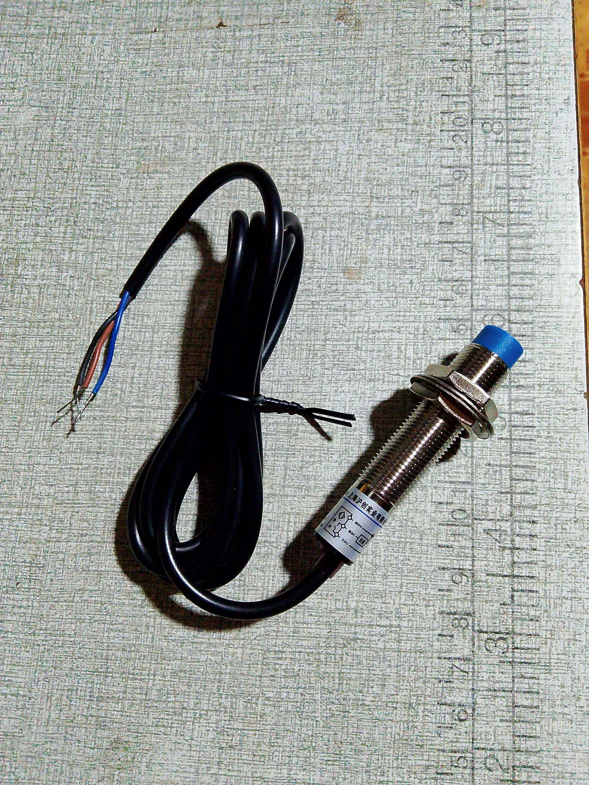

This is the inductive proximity sensor that I'm going to use
Basically you bought a random sensor, asks if it'll do the job, hopes we will be psychics.
Was Tom vague in his request?
C'mon, you're wasting your and our time here.
That looks like it is the sort of proximity sensor I worked with.
As I said, there is nothing you can do to alter the range.
You cannot.
LOL, what does that cost?
It has a simple digital output, possibly with about 5 to 10mm range for industrial limit detecting.
Not for metal detecting to distinguish between material types.
Why don't you try the simple detector posted in post #11?
It uses minimal components and so quick to construct.
