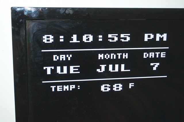

While I wait for the caps to arrive, I did manage to throw together some code and try it on one of my LCDs. I was able to pull the date and time out of my DS3231 breakout and display it onscreen. So far so good.
But now that I think about it and see how easy it is to display text on the TV, I might just go for it. If the TV I found is unrepairable, then I might just pick up a new one to hack. I think it’ll look really cool.
I replaced the caps in the mini TV. No luck. It's toast. I'm pushing on with the code in the event I come across another little TV. So far so good.

In any case, the project is full steam ahead. I got my hands on an old camcorder viewfinder CRT and got my code running on it. I chalked up a PCB and ordered it from OSH Park. I should have it in about 2 weeks. I can then put it all in a sweet enclosure and finalize the code.
