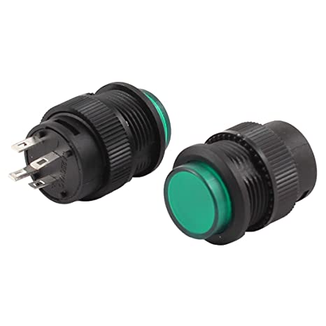

How do you add these pins into your circuit?
I just purchased this button thinking it could be inserted in a breadboard.
r16-503
I was wrong, I can't insert it in a breadboard. I'm new to electronics and I'm wondering how I can use it. It doesn't appear like it needs to be soldered. How does one properly use these pins?
You solder wires to them
I keep the cut-off legs from components like resistors and diodes on my soldering desk. When I need short stiff wires to push into a breadboard I will use those.
If you don't have offcuts, buy header pins that come in strips.
Push 4 wires/pins into the breadboard in the pattern you want. Balance the switch on top. Solder the first pin (carefully). Then solder the others. Unplug your newly-pluggable switch and install it whenever you need.
Those terminals can be soldered or you can use a 3.5mm female pushon wire terminal
3.5mm Female Push-on wire terminal (this is the standard dimension version of the other one)
Post the vendor link to confirm they are metric dimensions and not standard.
