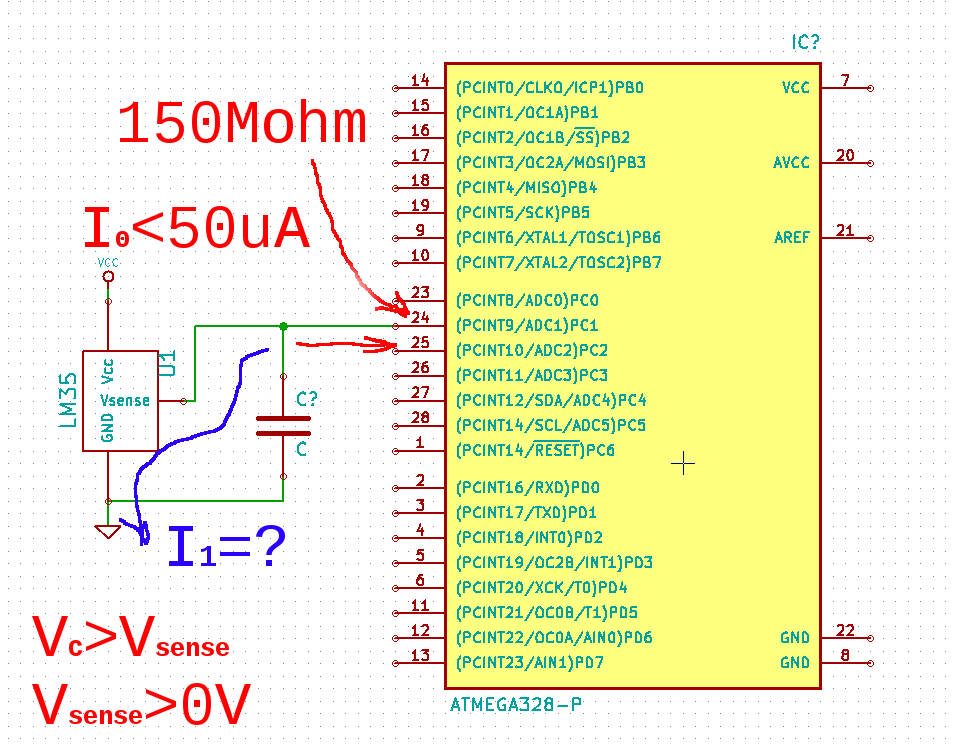

I really wouldn't add capacitor to sensor line, first of once you give voltage to that sensor capacitor will practicaly be short circuit to ground for that sensor, and wiht curretn rating of 50uA i don't think that would be good. Second, assuming sensor survives that, eventually that capacitor will charge, then when your temperature drops you'll have current through sensor discharging that capacitor (or less likely through arduino), which i can't immagine being good for sensor.
Even if all components survive this, your measurments won't be anywhere near real values. I'll put picture to illustrate shortly.
EDIT:
Starting condition:
Capacitor acts as short toward ground, and Isense shouldnt go above 50uA (if i read datasheet correctly).
Falling temperature condition:
Vc > Vsense but there is almost no current into arduino, and i have no idea how much towards sensor. It could:
  • damage sensor
  • be no current
If there is no current capacitor voltage will drop VERY slowly, so you will be reading capacitor voltage, not sensor voltage, thus wrong temperature.
The rated maximum current in the data sheet is 10 mA output current. You could add a resistor before the filter capacitor if you are going to use a larger value cap. Resistor size to never draw more than 10mA: 5 V / 0.01 A = 500 Ohms. The resistor does mean that you will get a small delay on the input you see, but it also increases the filtering. If you use a 10 uF cap (probably overkill for 2m wires) you will get a rc time constant of 500 Ohm x 0.00001 F = 0.005 seconds or 5 ms. This means your analog input will see 63% of the sensor voltage after 5 ms or 99% after 25 ms. Probably not something you will notice. A smaller cap will give you even shorter times.
You are right, my data is for TMP36. But still, will LM35 sink reverse current at 10mA?
Well, it sounds like it will certainly need a current limiting resisitor, preferably close to the ic. From the data sheet:
CAPACITIVE LOADS Like most micropower circuits, the LM35 has a limited ability to drive heavy capacitive loads. The LM35 alone is able to drive 50 pf without special precautions. If heavier loads are anticipated, isolating or decoupling the load with a resistor is easy (see Figure 14 ). Or you can improve the tolerance of capacitance with a series R-C damper from output to ground (see Figure 15 ).
As for sinking the 10mA, it would only ever have to when power is cut to the device. I don't know what happens to the impedance of it's output then. But I doubt that it will take damage. The atmega chip might also drain the capacitor as it has diodes to Vcc on the i/o pins. When the power rails voltage falls because power is cut, the diode will eventually discharge the cap - I guess.
