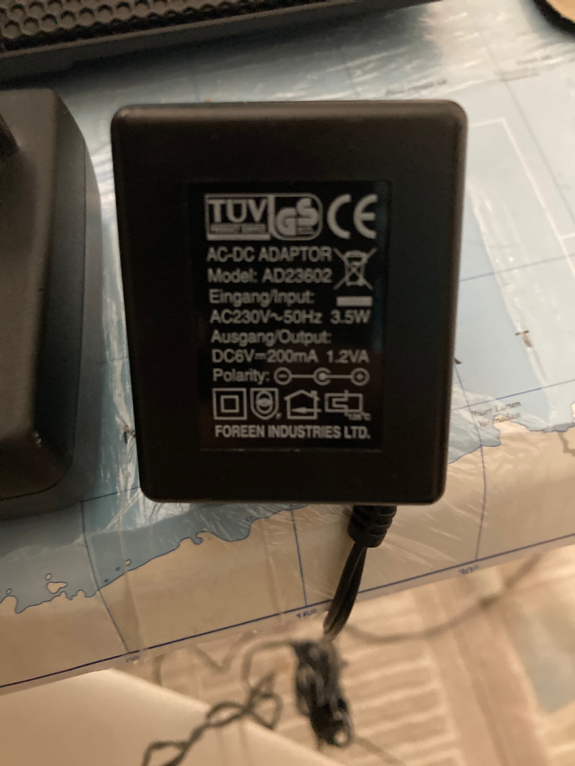

so i was planning to use my arduino from the barrel jack dc and i have a wall adaptor that convert 242 volts Ac to 6 Volts 200mA that apparently has 1.2VA which is 1.2 Volt-Amps
here's the photo: ( by the way i live in Turkey)
IIRC, you need at least seven volts.
The Arduino will only take as much current as it requires. You cannot feed it too much current
However, 6V is not really enough to use the barrel jack because there is a voltage regulator after it in the circuit to drop the voltage to 5V used by the Arduino and a larger voltage differential is needed for the regulator to work
It may be worth giving the power supply a try as its output may be higher than stated and no harm will be caused if it is not. Note that even if the Arduino works with the power supply then I would not rely on it as its output may drop below what is required as the load increases
Have you got a mobile 'phone charger with an output of 5V ? If so then you can feed 5V directly to a 5V pin on the Arduino
but The real question is how much VA(volt-amps) could an arduino take and also the only power brick that is 200mA or0.2A that i have

ok but would an 200ma (miliamp)could do it? and im also using an arduino klon or clone
I think that you did not understand voltage and current. You apply a voltage and the Arduino takes as much current as required. Increasing the unregulated voltage has no effect on the current.
It will shut down if it deserves more current than your PSU can supply.

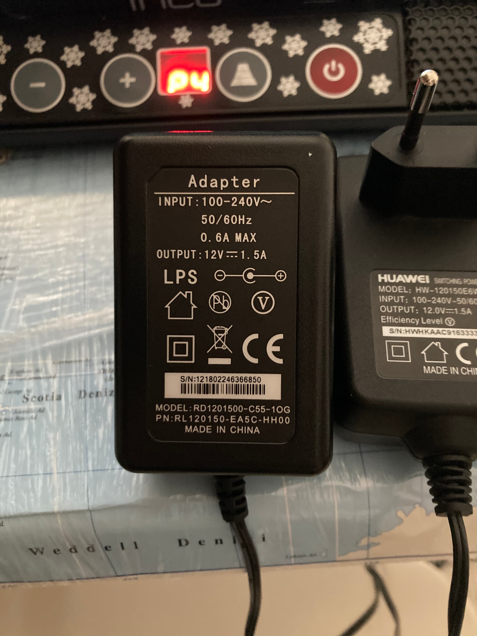

i have 12 V 1.5 Amp adaptor but i dont wanna fry my arduino like last time
What did you do last time that fried the Arduino ?
12V into the barrel jack is OK. Not ideal as it wastes power but it will work. 1.5 Amps is enough for a basic Uno
Make sure that the barrel connector of the power supply is centre positive and do not use it if it isn't

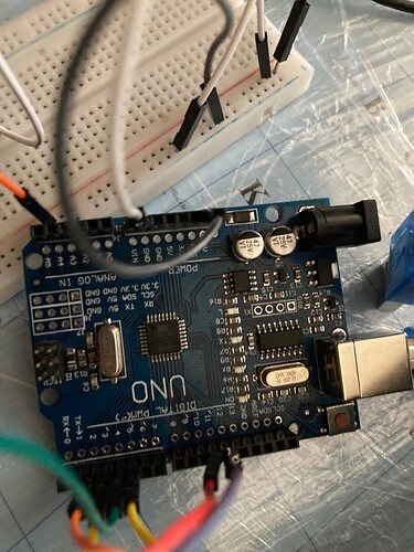

and also heres how my arduino look

which adaptor should i use
150mA @ 12V is enough, the voltage regulator does not allow for higher current. 250mA @ 9V, 500mA @ 7V.
Oh dear. No wonder that it didn't end well, but which Arduino has a 3.5V pin ? Do you mean the 3.3V pin ?
The Uno barrel jack will work with 7V to 12V DC, centre pin positive so your 12V supply (the first picture) should be OK

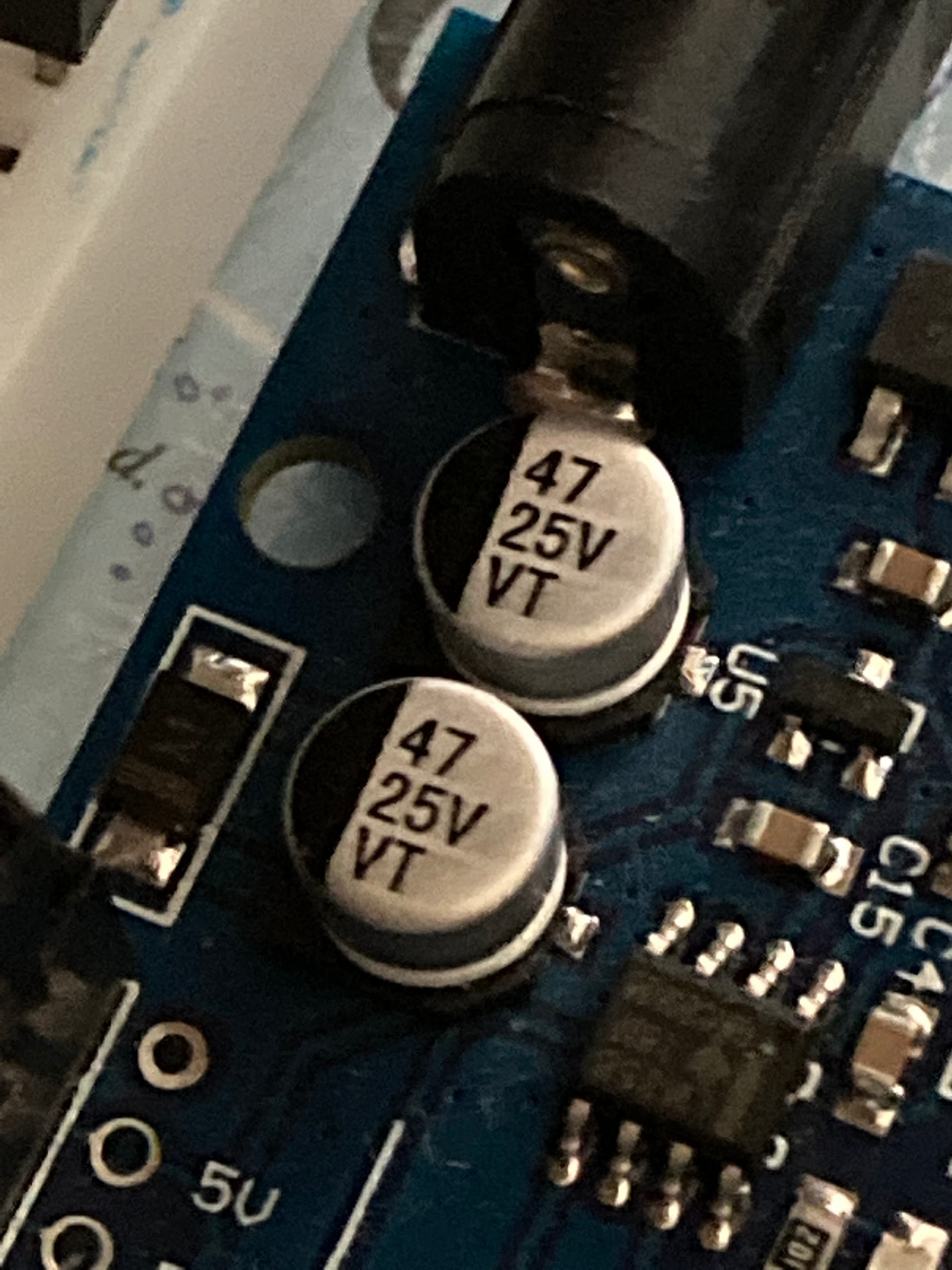

yeah i meant 3.3 also wouldnt 1.5A be 1500mA? btw is this the regulator?
the capacitor looking thing?

The capacitor looking things are capacitors
