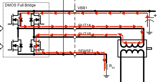

Step 1
If a certain current is now to flow through one of the stepper coils, the coil is connected to the buffer capacitor via the H-bridge. The full capacitor voltage is now applied to the coil. The current flowing through the coil increases. Ultimately, some of the electrical energy stored in the buffer capacitor is now transferred to the coil. This current also flows through the current measuring shunt, and when the voltage drop at the shunt reaches the set reference value, the H-bridge switches off.
As already mentioned, however, the current through the coil cannot simply be switched off - it continues to flow in any case.

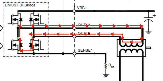

Step 2
In fast decay mode, the H-bridge is switched so that the current flows back into the buffer capacitor.
The external current flow is reversed - the voltage drop at the shunt becomes negative and the voltage at the coil also changes sign. The coil is now a generator and part of the energy just transferred from the capacitor to the coil is now pumped back into the capacitor. This causes the current to drop relatively quickly ('fast decay'). Current measurement is no longer possible, which is why this mode is time-controlled (approx. 10µs for the a4988).

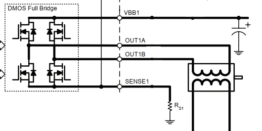

Step 3
After this, the system switches to 'slow decay'. The coil is short-circuited via the H-bridge.
No more external current flows in this phase, the voltage drop at the shunt is 0. Energy is now only drawn from the coil via the losses in its ohmic resistance and possibly (during movement) via the magnetic fields in the motor. The current now only drops more slowly. However, the driver cannot measure this current either, which is why this mode is also terminated in a time-controlled manner and it reverts to step 1
