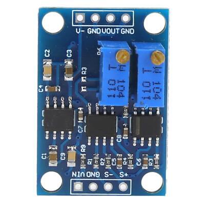

However as its a school project you could try using one of these to amplify the signal from the plant.

The name is instrumentation amplifier.
I'm simply trying to read the data and output it for something that the user could understand I just want the arduino to read the signals and translate it into either a kind of sound effect depending on what the plant might need or show a symbol on a screen.
Thank you, I think this is more on my level and easier compared to trying to understand the circut and then build it within my limited time frame.
