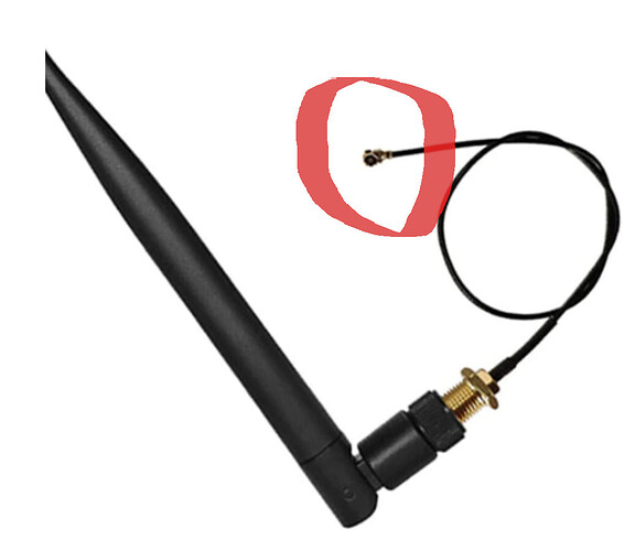

How to attach the antenna to the PCB?
How can I attach the antenna, shown in the picture, to the PCB? what type of connector is to be soldered to the PCB to receive the the small connector (see red "circle" in the picture). Any link to aliexpress or ebay that sells the connector? Thanks.
https://www.aliexpress.com/wholesale?SearchText=ipex+connector
Thank you very much.
An alternative solution is get an male-female(*) SMA cable and an SMA pcb-mount socket. This will have much lower losses than the puny little coax pictured. And SMA connectors are plenty small enough for human fingers(!)
(*) check the gender of the antenna connector though, WiFi antennas tend to differ from everything else.
