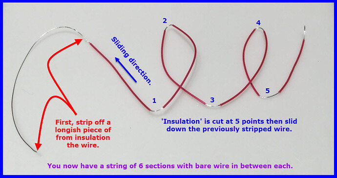

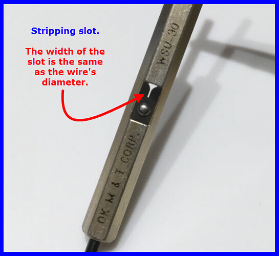

I dont have that wire or the stripping tool(s) so thats great for when I get them, but i still have a lingering doubt. What Im interested in is what the pdf author calls daisy chaining on page 5/5. He says "make several sections of movable insulation". Does this stripping tool allow you to cut out insulation from the mid-section of a length of wire? How?
“Does this stripping tool allow you to cut out insulation from the mid-section of a length of wire? ”
Yes.
The tool’s has a slot in the stripping section where the insulation is cut just down the wire.
It should be noted that this slot does not damage or cut into the wire.
When the tool is held stationary and the wire is pulled, the insulation is pull off from the left side of the PDF image.
Once a section of insulation has been removed, you repeat the process, however, this time you just slide this insulation up to but not off the end of the wire.
You then repeat as necessary.
You have a wire as shown below (give me time to take the picture).
You can do the same with stranded wires.

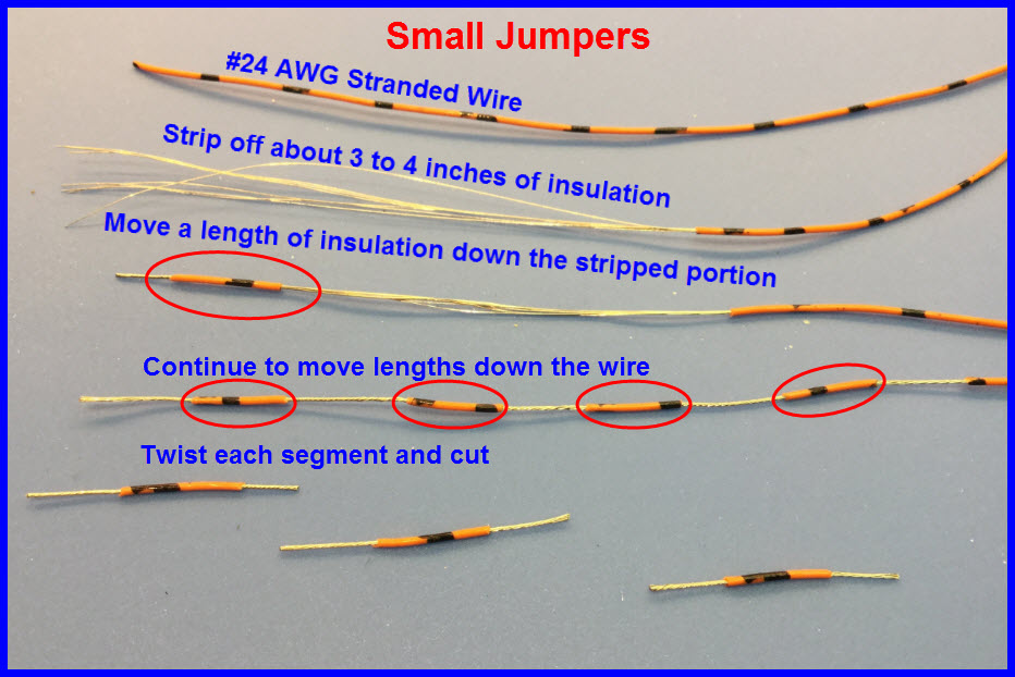

From post #336
https://forum.arduino.cc/index.php?topic=445951.msg3385026#msg3385026
The above can be made with the ST-100 wire stripping tool.
You could also get tubing and cut it to length as needed to put over bare wire.
https://www.mouser.com/Search/Refine?N=254628
I did something similar by cutting the insulation in the middle of the wire length and then move the insulation by hand one cm to one end. This created one cm bare copper segment in the middle of my wire. :slight_smile:
