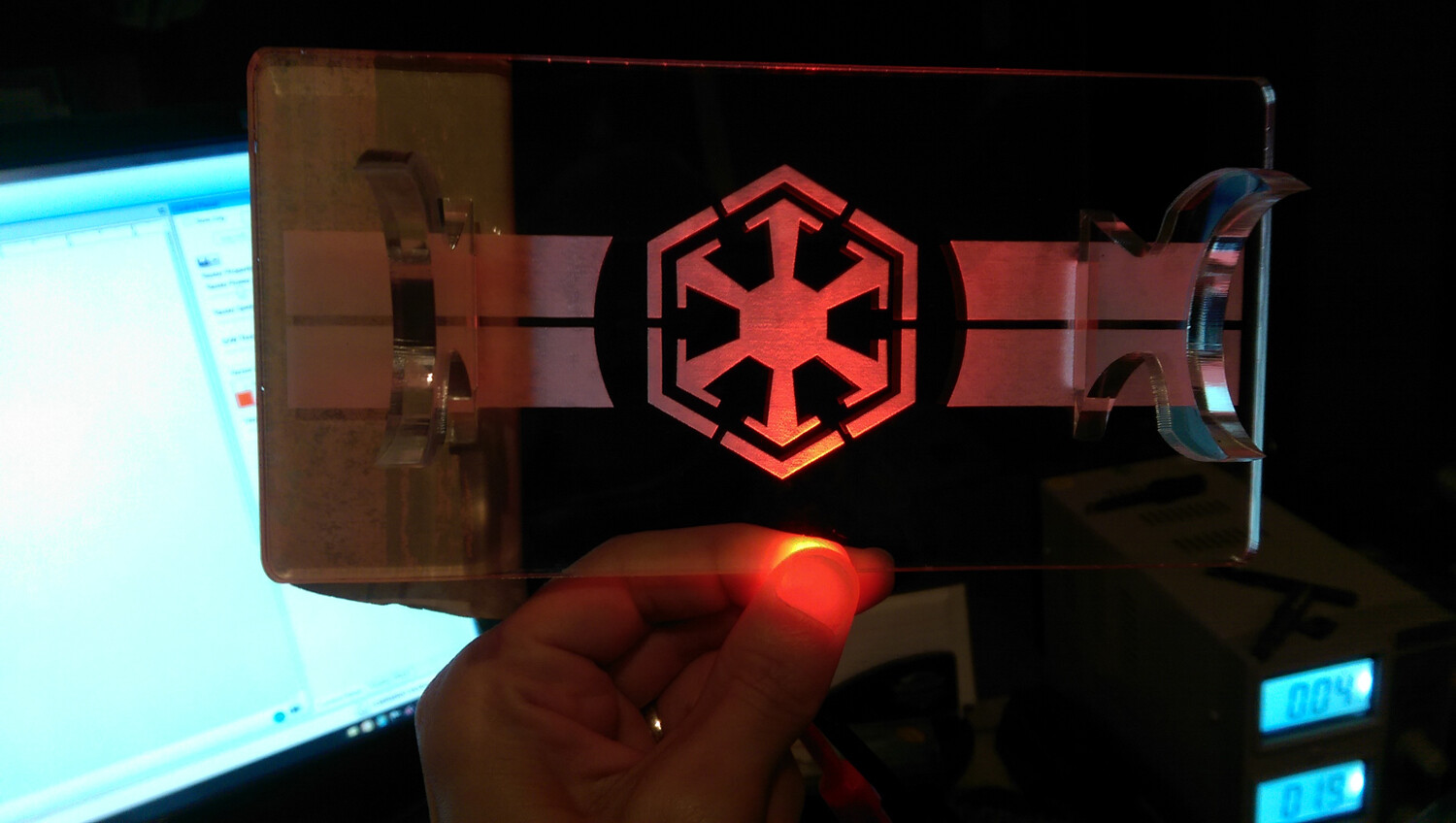

I've made an RGB bluetooth controlled lamp with mine and other odds-n-ends..
lightsaber stand..etc:
The 5th gen also has the bonus of a removable floor, so you can put material UNDER it that wont fit inside and engrave or cut from it.
