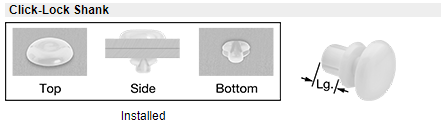

Late to the party but, if there's clearance between the device metal tab and the PCB you might could use push rivets (McMaster-Carr) to fasten the heat sink.

You will inevitably have to put some screws through your TO-220. I would opt for two heatsinks one for each row. Reason it might be more difficult to get the to-220's flat to the heatsink.
If you don't expect them to get too hot you can use nylon screws, else you will need metal with something so the screws don't touch the tabs. For hobby I use a couple layers of heatsink on the screw.
I have some double sided thermal tape 3/4" wide that was used in an automotive application. If you PM me I will send you some.
Thermal kits should include the isolating plastic top-hat washers for insulating the transistor tab from the screw. Don't use nylon screws for heatsinks they get brittle with heat and age and might eventually fail. If you must use plastic screws go for a high-temperature plastic like PTFE or PPS.
