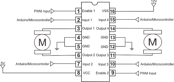

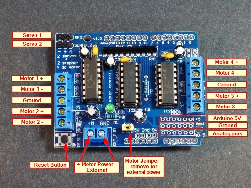

I do not see a TX or RX on either the I.C. L293D or the Module L293D. Please, be more descriptive. I am very on Earth.
