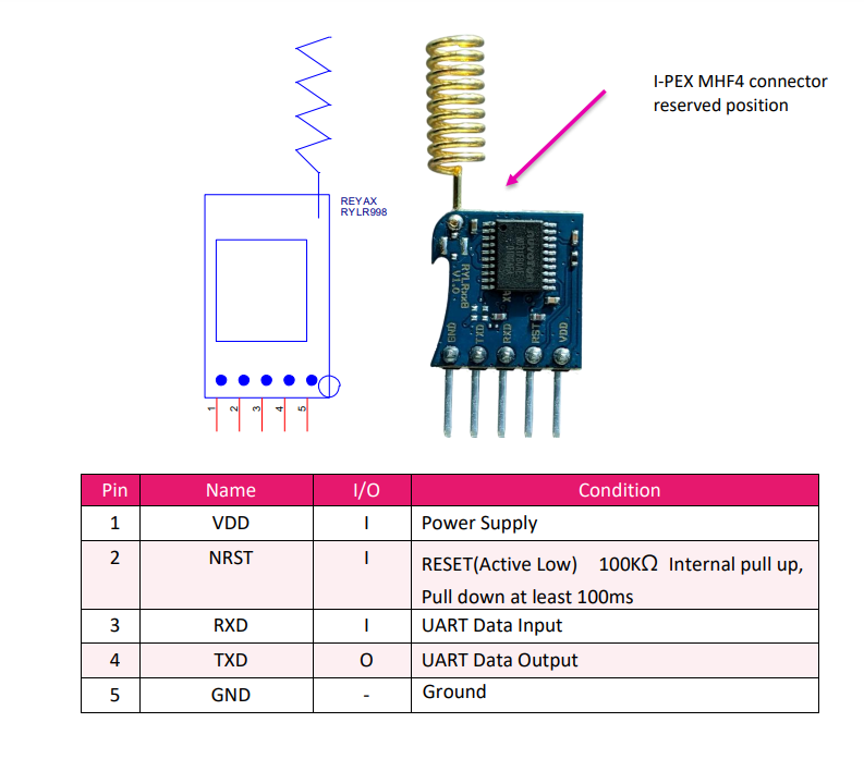

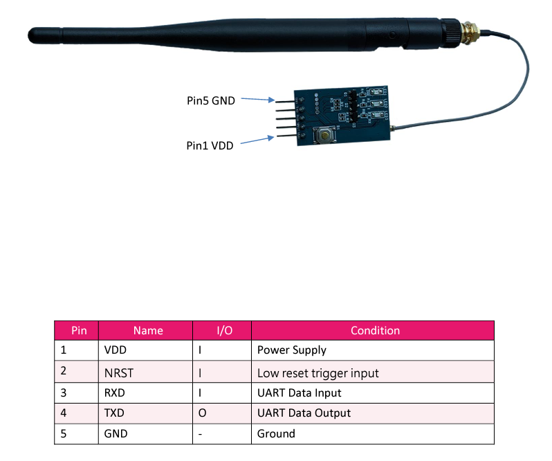

and would like to start with just connecting them and sending "hello from r3" and vice versa. I'm stuck on how to physically connect RYLR998 and RYLR993_lite
to either UNOs (wiring).

REYAX RYLR998 datasheet
REYAX RYLR993_lite datasheet

The REYAX radios are 3.3V only, so they cannot be directly connected to either the Arduino Uno R3 or R4 WiFi, which use 5V I/O.
With those processors, you will need bidirectional logic level converters, or better, buy two 3.3V Arduinos (any will work).

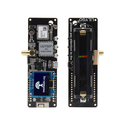

This one is useful to have;
LoRa module, antenna socket, display, GPS and lithium battery so its easily portable and useful for range testing etc. You can even get 3D printed plastic cases for it.
Not a lot of use for a remote sensor though, deep sleep current is a tad to high.
