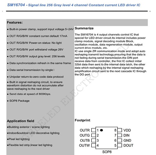

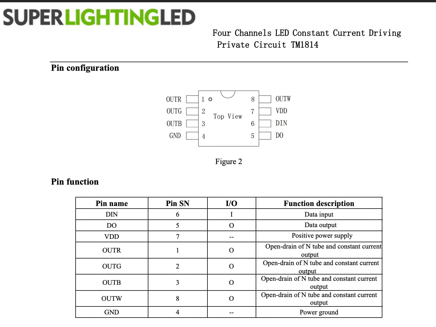

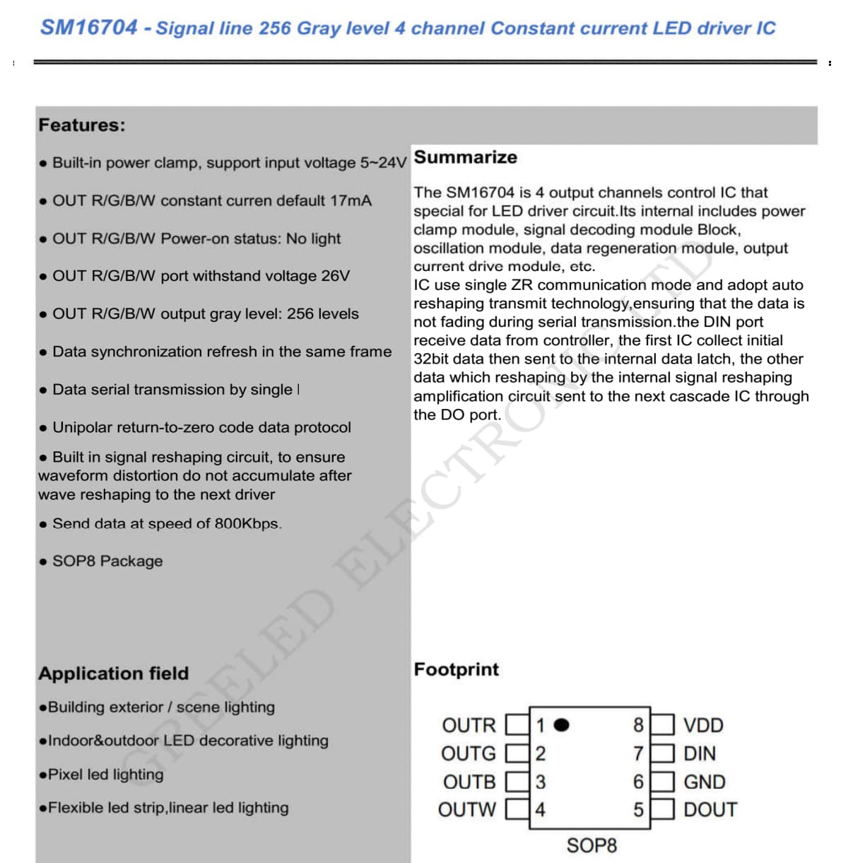

Possible candidates: UCS2904, SM16704 or TM1814.

Then you have to have a 4 channel controller like:
Or with a 3-channel chip per:
...mayyybe you could do something by interlacing WS2811A chips with integrated WS2812 LEDs, but that would seem overly complicated, expensive, and silly.

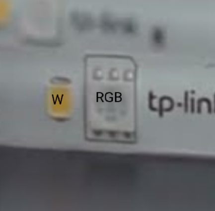

Interesting theory, but the RGB LEDs on @swizzlevixen's strips have 6 pins:
like an RGB 5050 led:
which are needed in order to connect 3xR in series, 3xG in series, 3xB in series for 12V operation.
A ws2812 led has only 4 pins:
Well, that puts that theory to rest.
Definitely need more data.
OP could check continuity between the LED and whatever else is on the strip & it might give some hints.
5050 + White LED

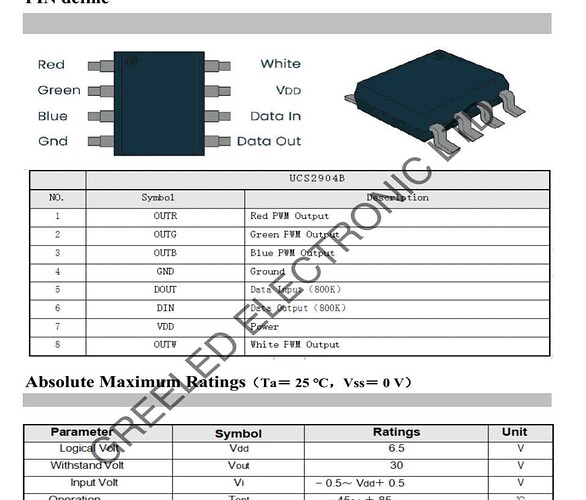

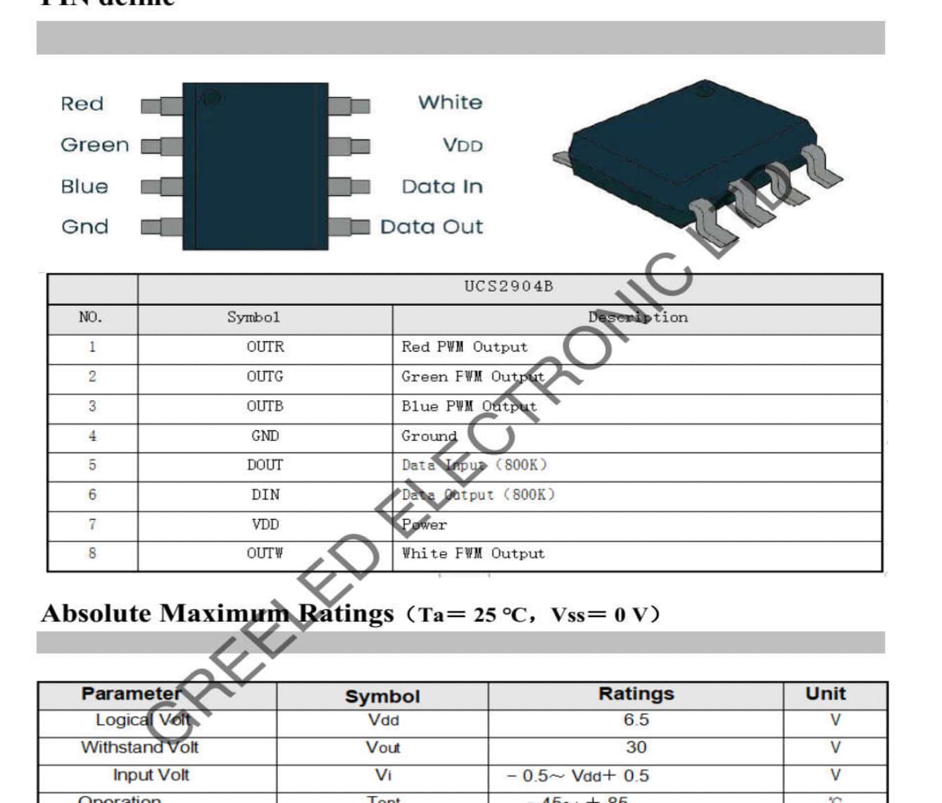

Here's the pinouts for these 4 channel ships:

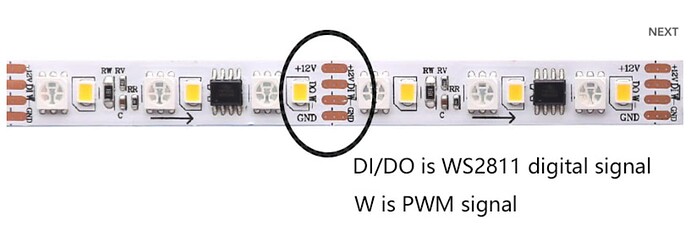

And strip:
https://www.superlightingled.com/ws2811-dc12v-addressable-rgbwhite-color-changing-led-lights-strip-p-4537.html
That particular strip has a separate "W" line:
...as per this rejected theory:
Like the one OP has..
