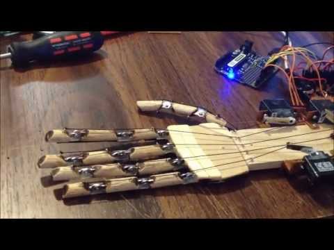

How to make a Arduino hand
Before I send you a quote please try this: Get a pair of really strong leather gloves (biker gloves, welder groves, even latex coated gardening gloves will do) and try to braid hair. Reason for me asking is that you don't have haptic feedback from the hand. If you need haptic feedback it's a different story.

So no feedback, thumb with 2 DOF, all others with 1 DOF (simillar to the video)? Forefinger and middlefinger are sometimes realised as 2 DOF - in case you need more precision (the formost section is never implemented as a seperate DOF).

The video you have shown is one of the most basic example of Robotic handling of objects.
But the problem you state requires much more work than that.
It is quite obvious you have an end goal in mind without proper understanding of the task and hence the underestimation & oversimplification.
But the task would entail:
a) Basic physical modelling of the hand.
b) Inverse kinematics to workout the mechanism.
c) CAD to visualize the complete 3D model of the hand
d) Electrical & Electronic subsystem design.
e) Planning & control of the motion.
That should maybe lead you to a level of working prototype from where you can improve upon.
Now the question is, do you acknowledge these steps are required here?

Are you aware that human eyes and sense of touch are needed to do hair braiding, a relatively complicated process for a machine.
What is the advantage of having a mechanical hand copying a real hand?
If you want to braid remotely, you can still only braid one head at a time.
Do you see the missed logic in what you want to do?
If you want an AUTOMATIC braider, then this forum is out of that league.
I have minor experience
Nothing of a school level
I agree this will take research so I will have to digress from this until I am have more knowledge in this area
