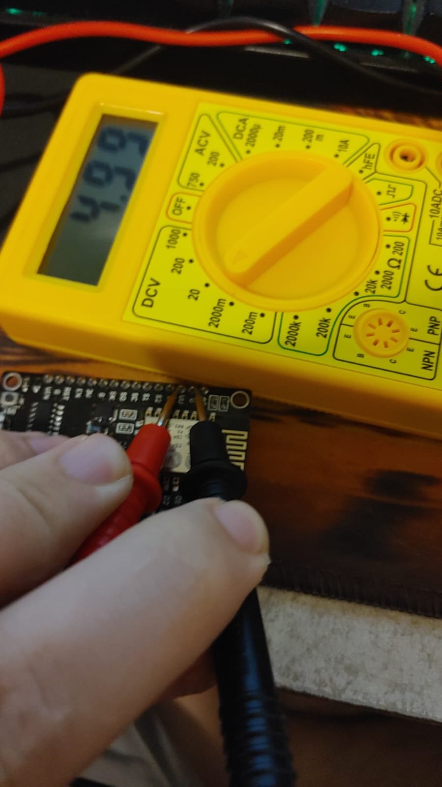

I have a 100 ohm resistor,
In this test it was 4.98V, is the value correct?
That looks good.
If it works with USB powert then it should also work with 5V on Vin.
However, I can't explain why it does not.
One more test.
Power the NodeMCU via USB and check the voltage on the Vin pin. It should be greater than 4.75V
doesn't work, in VIN, marks only 0.24V, but my nodemcu have VU pin, in VU pin I have 4.95V, in 3V pin I have 3.3v
