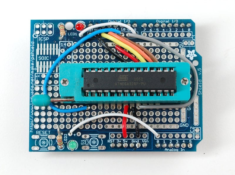

How to program micro Atmega 64 using Arduino Nano
Hello
I want to program an Atmega 64 micro using Arduino Nano in such a way that I put the hex file on the main program or in the external memory.
Please help me if anyone has any information on how to write a program like this
MCUdude MegaCore supports the ATmega64. Check whether external program memory is supported by the core and by the bootloader.

Thank you for your reply, but I have already done this by using a laptop to load the bootloader and then program the program, but I want to use the Arduino Nano micro64 ATmega without using a laptop and only by connecting the micro Program to Arduino by pressing a key and the hex file that I want to program is either inside the Arduino program itself or in the external storage of the SD card.
I asked ai and he gave me this program, that is, the hex file of the LED program, which is: 100000000C94A6000C94B8000C94B8000C94B800A2

I gave this to him and he gave me the following program, but I tested it and it didn't work, please help if anyone knows
#include <SPI.h>

Hello
want to use the Arduino Nano ATmega 64 without using a laptop and only by connecting the micro Program to Arduino by pressing a key and the hex file that I want to program is either inside the Arduino program itself or in the external storage of the SD card.

I have a program named optiLoader which loads micro atmega 8 with its bootloader. I want to change this program so that it loads the hex file on micro atmega 64 using Arduino. I changed the program as below, but the hex file is complete. It doesn't work. Please help me to put the hex file on the micro atmega 64 with Arduino

// Designed to connect to a generic programming cable,
// using the following pins:
// 10: slave reset
// 11: MOSI
// 12: MISO
// 13: SCK
// 9: Power to external chip.
// This is a little questionable, since the power it is legal to draw
// from a PIC pin is pretty close to the power consumption of an AVR
// chip being programmed. But it permits the target to be entirely
// powered down for safe reconnection of the programmer to additional
// targets, and it seems to work for most Arduinos. If the target board
// contains additional circuitry and is expected to draw more than 40mA,
// connect the target power to a stronger source of +5V. Do not use pin
// 9 to power more complex Arduino boards that draw more than 40mA, such
// as the Arduino Uno Ethernet !
// If the aim is to reprogram the bootloader in one Arduino using another
// Arudino as the programmer, you can just use jumpers between the connectors
// on the Arduino board. In this case, connect:
// Pin 13 to Pin 13
// Pin 12 to Pin 12
// Pin 11 to Pin 11
// Pin 10 (of "programmer") to RESET (of "target" (on the "power" connector))
// +5V to +5V and GND to GND. Only the "programmer" board should be powered
// by USB or external power.
// Pin 13 to Pin 13
// Pin 12 to Pin 12
// Pin 11 to Pin 11
