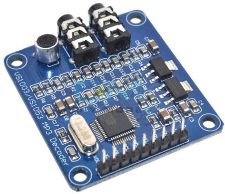

Hi Class,
I'm testing a VS1053 board and an ESP32 devkit 1.0.

I recorded an MP3 on the SDHC card (test.MP3) and I can listen to it normally by connecting headphones to the VS1053 board.
The board has a microphone. How do I test it? I want to say something and also listen to it on the headphones and record it on the SD card.
Anybody know ? Or does anyone have a link with already tested code that does this ?

Updating with more information:
The board I have is this:
vs1003
I'm trying this other code. I think it was written for Arduino Uno. I am using ESP32. Even so, with hope, I did a pin assignment but the serial monitor only showed: VS1053 not found.

I use a separate SD CARD module because the VS1003 board does not have one.

The board I'm using has the VS1003b chip and not VS1053. That's why it doesn't record in OGG or MP3. I bought it in a hurry and didn't know about this detail. In fact, what made me not look so closely was seeing it painted white on the edge of the VS1003 / VS1053 board.
Recording from the microphone to the memory card in OGG or MP3 will not work with this card.
