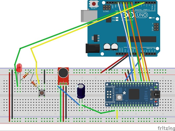

hi, mi name es ramiro i'm from argentina. I'm doing my final college work
i built a recorder voice with vs1052 and microphone max9814
i read the Recording with the VS1053 - adafruit industries that was very helpful
This is my video project where i show my problem
- YouTube
the sound is not recorded correctly
this is my scheme

thanks for your time
