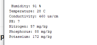

The changes that I made were:
  1. change the baud rate to 4800
  2. change the starting register address to 0x00 and then fetch the individual values from (0x00 to 0x08). I kept 0x07 and 0x08 just for checking that whether it returning extra values or not
The conclusion that I can draw from results is. This is indeed a 7 in 1 soil moisture sensor. Since it's returning 7 values in the results.

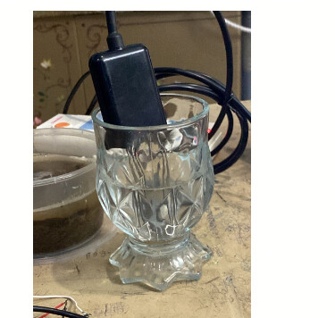

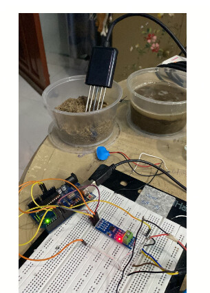

I am attaching the pic for result when soil moisture sensor is inside the soil
This picture result is for when soil moisture sensor is outside the soil (sensor is not touching the soil and is outside)
I can't identify which value is for which parameter. used this convention for naming highlighted in yellow
I think I get it mark. The sensor responds to these values
what I don't understand is
how in PH 56 get's converted to 9
and nitrogen gets converted to 56 from 32
and phosphorus gets converted to 56 to 88
and potassium gets converted to 104 to 104 only how is that working
Sounds like you've made a lot of progress and good news that the sensor is responding reliably.
Ok, so pH: If you receive a value of 5A (hex), then that = 90 (dec). pH is usually sent x10 the actual value so you can get 1 decimal place. Therefore you need to divide the received value by 10 to get the actual value to 1 decimal place. So for a received pH value of 5A (hex) => 90 (dec) => pH 9.0
Same for Nitrogen. You received 20 (hex) => 32 (dec). But, I think N, P & K are the actual values as there are no decimal places so the Nitrogen value is 32 mg/kg.
Same for Phosphorous and Potassium.

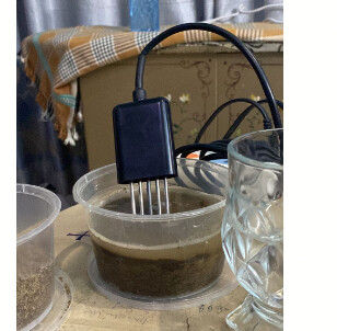

Thanks @markd833
The sensors corresponds well. I tested it on 3 soils.
1 Dry soil
  1. partially soluble soil
  2. Tap water
I think responds correctly to the parameters that are there

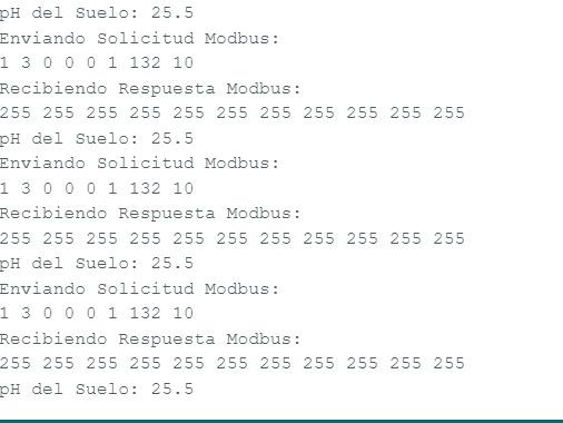

@markd833 Could you help me, I am using a soil ph sensor, I want to communicate it with my esp32 and TTL to rs485 module, but I have this response.
WhatsApp Image 2024-01-16 at 5.06.01 PM
#include <ModbusMaster.h>
#define RE 25
#define DE 26
const byte ph[] = {0x01, 0x03, 0x00, 0x00, 0x00, 0x01, 0x84, 0x0A};
byte values[11];
  Serial2.begin(4800, SERIAL_8N1, 16, 17); // Usa Serial2 para la comunicación
  pinMode(RE, LOW);
  pinMode(DE,LOW);
  byte val;
  // Habilitar transmisor y receptor
  digitalWrite(DE, LOW);
  digitalWrite(RE, LOW);
  delay(10);
  // Enviar solicitud Modbus
  Serial.println("Enviando Solicitud Modbus:");
  for (byte i = 0; i < sizeof(ph); i++) {
    Serial.print(ph[i], DEC);
    Serial.print(" ");
  Serial.println();
  // Verificar si la solicitud Modbus se envía correctamente
  if (Serial2.write(ph, sizeof(ph)) == 8) {
    // Deshabilitar transmisor y receptor
    // Recibir e imprimir la respuesta Modbus
    Serial.println("Recibiendo Respuesta Modbus:");
    for (byte i = 0; i < 11; i++) {
      values[i] = Serial2.read();
      Serial.print(values[i], DEC);
      Serial.print(" ");
    Serial.println();
    Serial.println("Error: Solicitud Modbus no enviada correctamente");
  // Calcular e imprimir el pH del suelo
  float soil_ph = float(values[4]) / 10;
  Serial.print("pH del Suelo: ");
  Serial.println(soil_ph, 1);
  delay(3000);
Your code includes the modbusmaster library but you don't use it.
Have a look at this discussion:
And the code in post #6. It shows how to use the modbusmaster library.
It will need a few simple tweaks for your sensor, but it will handle the modbus timings for you.
Hello dear @markd833 and @areebkhan02. Can you please help? I performed all the steps above up to post #21, but when I reconnected my sensor I had no RX address. Would be this associated with the sensor problem or voltage powered the sensor? Can you please give me a direction, where to start? I am also working with seven in one soil sensor.
Thanks in advance.
