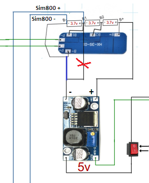

A problem lies in the GND SIM808. When I take it from the Arduino Nano, the BMS piece does not work. The controller stops working. I want a solution to this problem. I do not know where the error is in the connection and whether the circuit connection is correct.
Your battery connection looks incorrect for me. The "IN -" wire of your DC 5v converter is connected to "B1" terminal of the BMS - the same point as "plus" of the SIM800 module

The correct scheme should be:

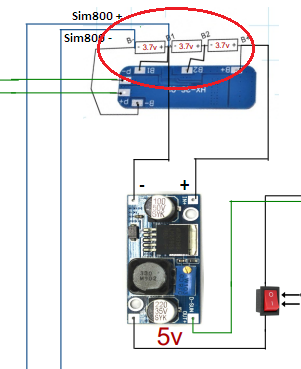

Scheme2
You should connect the "IN -" of the DC 5v converter to the "B -" terminal of the BMS module rather than to "B1".
When adding gnd, which is in red (here), the sim808 stops working. The arduino nano also stops working, but when gnd is removed, it stops working. And I want gnd to work and send location gps without gnd (here) it will not work at all.
Again - you have a error in the schematic. The GND of arduino and VCC of Sim800 are connected to the same point, so when you connect Arduino to Sim800, the result is a short circuit and nothing works.

I drew you what needs to be corrected in the diagram in post #8
