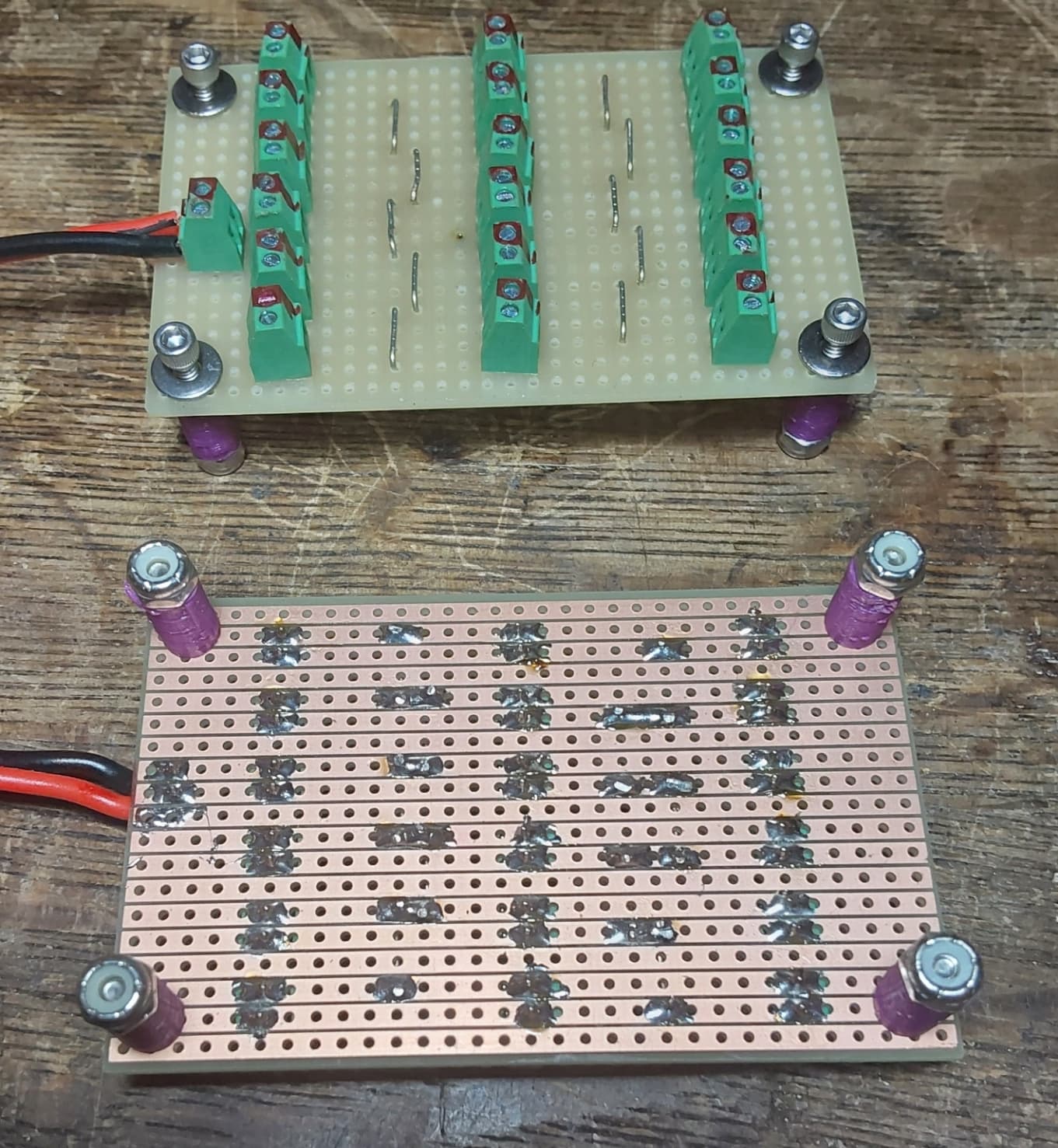

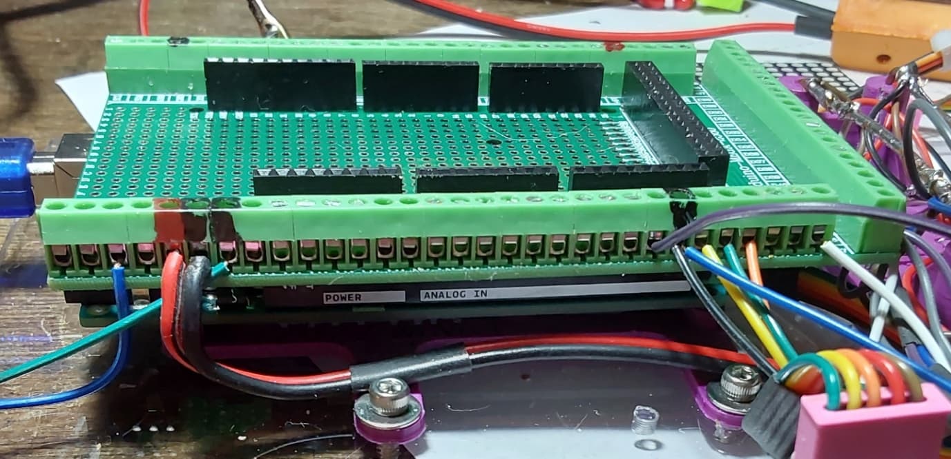

Here's what i came up with when facing the same situation.
It screws directly to the terminal shield on the Mega 2560
Everything mounts on 3d printed bases. I can send you the .stl for the mega/uno base if you like.
Sure, that would be great thanks.
And love this - really neat - I can see I've got a bit more research to do on prototyping.
Thanks for sharing👍
1:1 PCB layout
I was thinking of having a batch of these made. They fit the MEGA terminal shield. Anyone interested in splitting the (as yet unknown) PCB fab costs -- OR -- does anyone know a REALLY CHEAP place to get these made. I can fab 'em on a proto card but this is cooler looking - Only needs single side with six wire jumpers topside. Cap is 470uF @ 35V (10mm can, .2 leg spacing). LED and R1 are your choice. RGB color change LED & ~150 ohms is cute. LED pad is T1-3/4.
