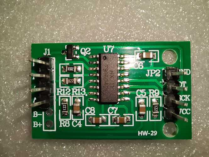

According to the datasheet, E- must be tied to ground, and E+ comes from a PNP transistor that is being regulated down by the HX711 to ~4.25volt (if you work out the feedback resistor divider ratio).

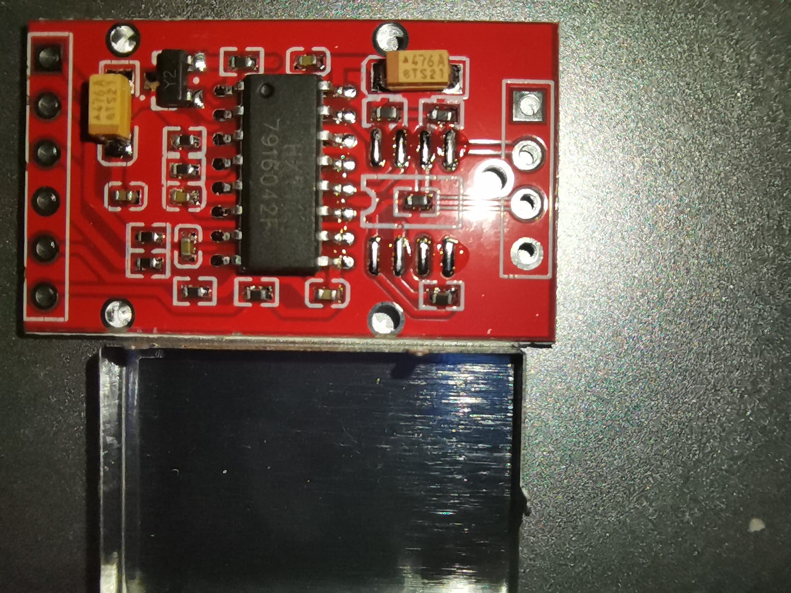

Like to see clear pictures of both sides of these boards.
Leo..

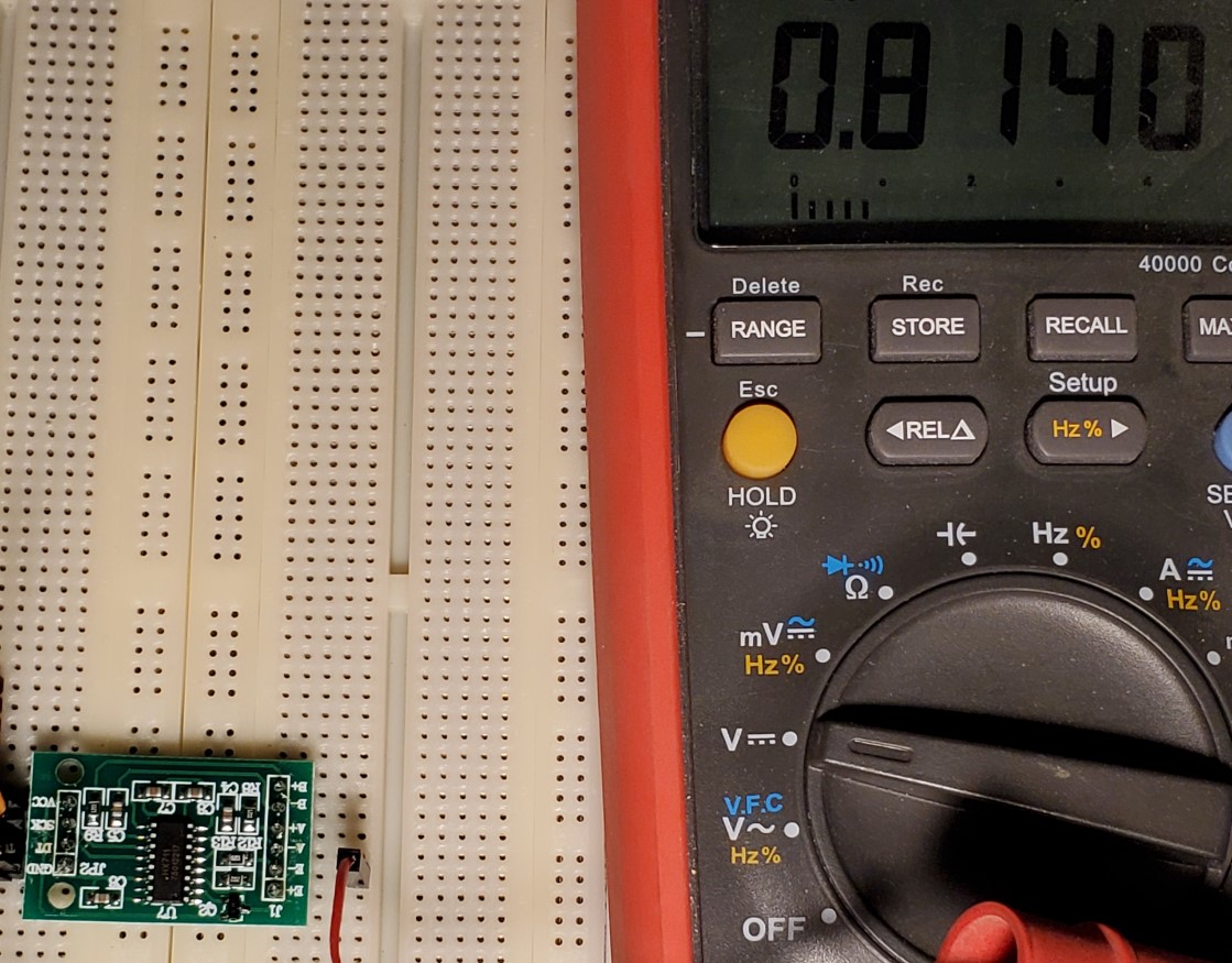

I just realised I had extras, and were able to measure a 4.25V on E+ on a new one (DT and SCK were floating). I dont know what happens if I try to ground them, I could check
Don't ground an output pin (DT)!
pics
E+
E-
front
back

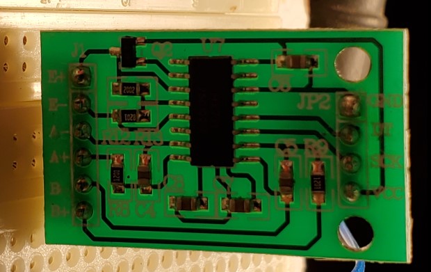

traces with backlight

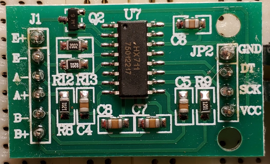

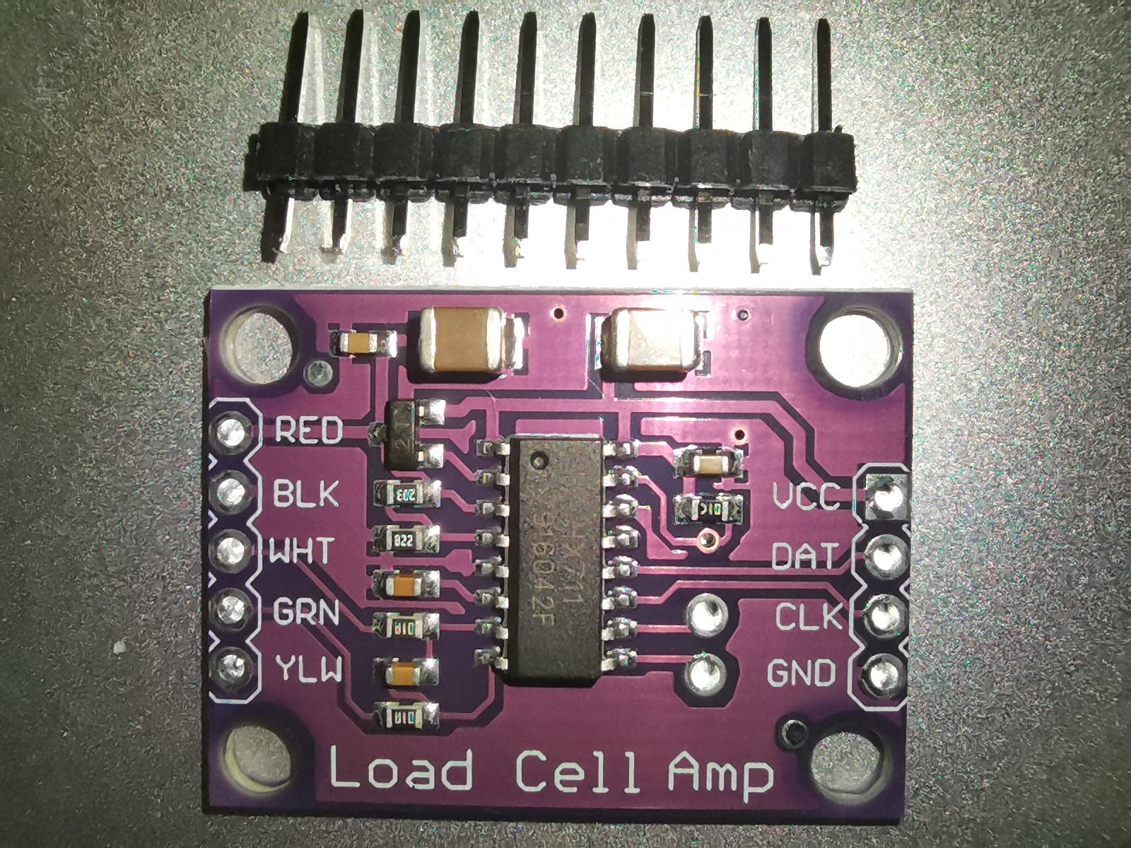

This appears to be one of those boards in which E- is not grounded (as mentioned by @Smajdalf). And, there's no ground plane (for noise reduction)...
I also have a Sparkfun HX711 but haven't soldered pins to it. Its E- is tied directly to the ground plane.

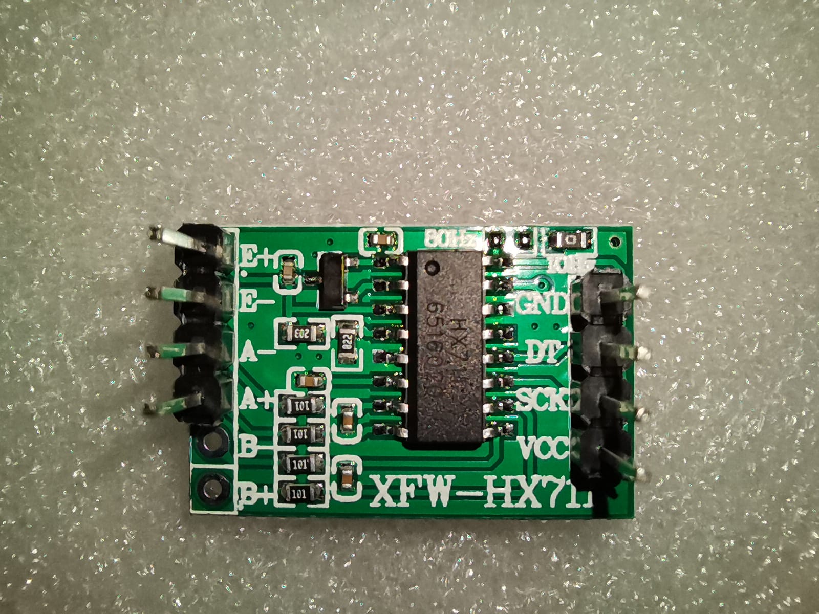

Thank you for the images.

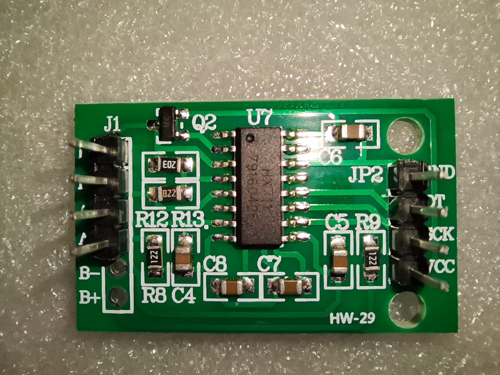

E- is normally grounded through the board.
The green board doesn't have E- connected to ground through the board.
If you don't, then the E+ regulator also isn't working, because it's 8k2 feedback resistor (8210) is floating.
It seems that with these boards you also must connect E- to Arduino ground.
Leo..
Wawa:
With E- grounded, E+ is 4.39v
This appears to be another example of "you get what you pay for" and caveat emptor.
The 8k2:20k resistor ratio on this module, with the 1.25volt reference of the HX711, works out to
(8200 + 20000) / 8200 * 1.25volt = ~4.3volt
0.09volt off is ok for a 5volt Arduino, but 4.39 volt is a bit close for a Nano on USB power (~4.6volt supply).
You must of course know what you're doing if you order undocumented cheap parts.
Leo..
