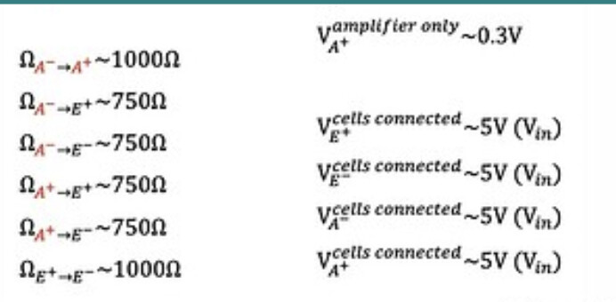

Oh, looking at this data:

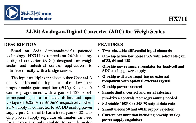

V_E- doesn't look right. I would expect it to be zero so as to apply an 5V excitation voltage across E+/E- junctions between the two load cells. Try checking E+/E- voltage with no load cell attached.

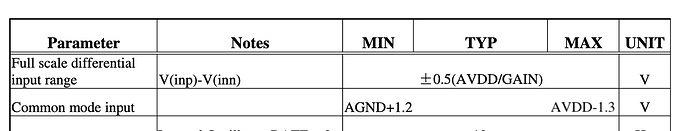

And 300mV across A+/A- is outside the range that the HX711 can accept and amplify linearly.
The reported resistances look correct for a properly wired ring made out of 4x 1000 ohm resistances.
This is the V_amplifier_only in the picture.

When not attached to the bridge, E+ to E- is 5V: E+=5V and E-=0V
When attached to the bridge, E+ to E- is 0V: Both 5V

If your A+/A- input voltage is bigger than 20mv (40mV?) then the amp will peg at one end of it's range about you'll be calibrating between nearly constant raw numbers, making the slope of the calibration be random.

That's the stand_alone_cell resistance in the picture, and the numbers as you mentioned - there is no mismatch between the colors.
OK, the only thing I can think of is that the E- on the HX711 board isn't good. If you wire just one load cell's white/black to E+/E-, E+ should be 5V and E- should be zero, with the red wire at 5V*1000/(1000+1000)= 2.5V If E- comes up to 5V, it is a bad E- on the HX711.
When bridge connected or not? When connected they're V_in, when disconnected it's 0.3v
E+ and E- were 5V.
The red was also 5V.
Point is I tried already 3 different HX711 (though all purchased from same shop).
When connected and operating, the bridge should be balanced enough to deliver a +/-20mV signal into A+/A-, If it does more, then the +/-20mV times the Gain hits the 0V/5Vrails at +/-0.020*128=+/-2.5V
Since when connected, everything is a 5V, then a 0.0000V difference between A+/A- is delivering a constant raw value to your calibration routine, and you are probably calibrating out-of-spec ADC noise to get your calibration slope
