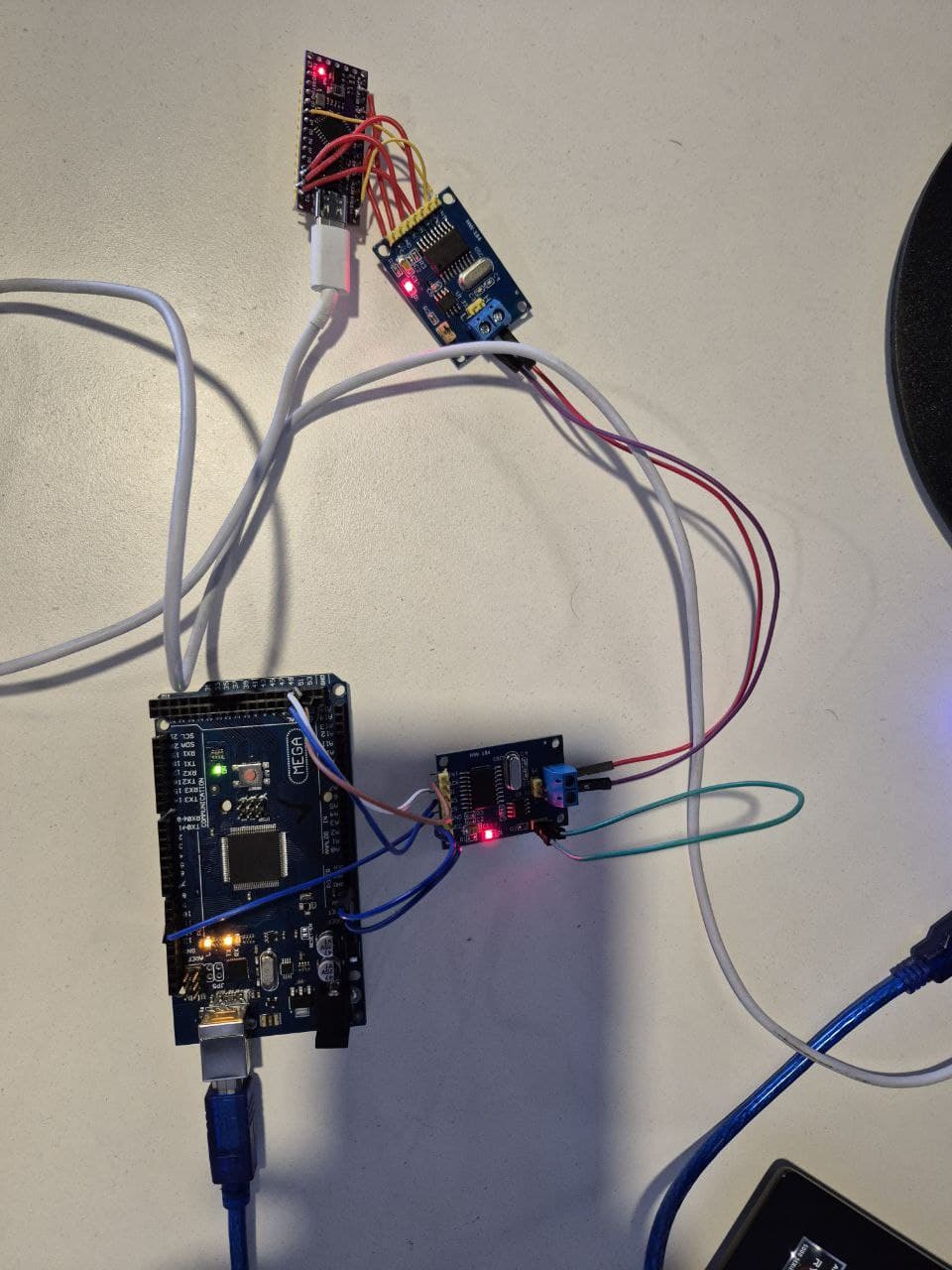

Hello all,
i have two mpc2515 can module. One of them is connected to arduino mega and the other one is connected to arduino nano. I will share the connection and everything. i am trying to send data one to other. The problem is that there is no data received or sent. i dont know what would be the problem here.

Error Sending Message...
receiver nano output:
Entering Configuration Mode Successful!
Setting Baudrate Successful!
MCP2515 Initialized Successfully!
MCP2515 Library Receive Example...
the modules have 8MHz crystal and i tried with different speeds. also i removed the jumpers and i tried without terminal resistor (i hoped that it will work but didnt) .

It appears you're getting exactly what you'd expect; nothing. I've posted below a schematic showing two Nano boards connected via CAN. In your setup, there's a block labeled "PC", what is it? Remove it from the circuit until you have the basic communication working.
Remember, the CAN bus has a characteristic impedance of around 60 ohms, which is achieved by placing 120-ohm terminating resistors at each end of the physical bus. Most CAN modules have jumper pins to enable this termination; ensure it's only enabled on the modules at the ends of the bus.
I've built many systems using MCP2515-based modules and the mcp_can library, and it works properly. The first thing you should see is a confirmation that the module initialized successfully. If you don’t see that, double-check your wiring. Also, start with nothing else connected to the Nano for initial testing.
Check the crystal oscillator value on your MCP2515 modules. Many modules are not all equipped with 8 MHz crystals as expected. If it's different, adjust your code accordingly. Lower your bit rate to around 125 kbps for initial testing. Use at least one meter of twisted pair wire to connect the modules—CAT5 or CAT6 will work, though note that their impedance isn't a perfect match for CAN. For CAT5/6, try to keep the bus length under 10 meters for reliable communication, and always ensure proper termination to minimize reflections and signal loss.
With both modules connected, terminations in place, and the code configured for the same bit rate, you should see basic communication begin. If one module appears to be transmitting but the other isn't receiving, the issue is likely with the interrupt pin wiring.
Lastly, be aware that Cory’s library does not come with per-assembled or tested modules, so verify the hardware carefully.

it is litteraly my "personal computer". i get power from usb.
i think my problem is with cables. i tried to read tf03 sensor which is supporting CAN communication. The one of the module that is connected with jumpers didn't work and the other worked and the difference was just wiring. i was using 22 awg wire for connections.
thank you both for your help
Have you got ALL the gnds connected together.
Canbus needs a GND reference.
