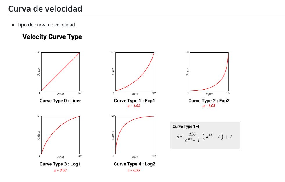

A couple of years ago a friend made me an Arduino for a drum but I wanted to make a modification and I don't know how to modify the code, the modification would be to be able to change the velocity curve (Linear, Log1, Log2, Exp...) using a position potentiometer like midi keyboards do, it won't let me upload my project.

The potentiometer on the left is the one that regulates the threshold, what I want is to replace it with a position for the speed curve and that on the screen it shows the type of curve and that the threshold always remains at 100

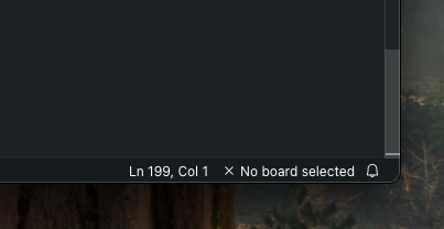

You mean that corner?
I don't understand steps 1, 2 and 3

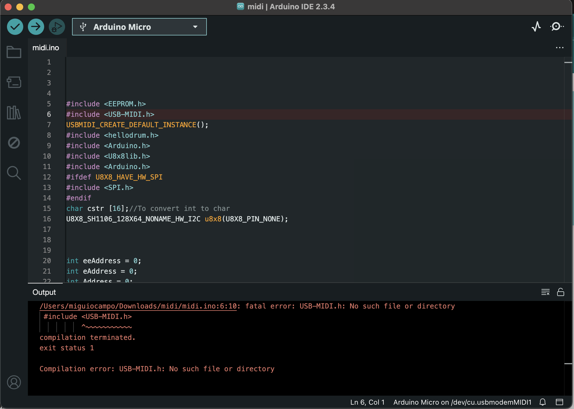

/Users/miguiocampo/Downloads/midi/midi.ino:6:10: fatal error: USB-MIDI.h: No such file or directory
 #include <USB-MIDI.h>
compilation terminated.
exit status 1
Compilation error: USB-MIDI.h: No such file or directory
Is this okay, friend?
Did you install the MIDI-USB library?
what's that?
The library it is telling you it can't find.
