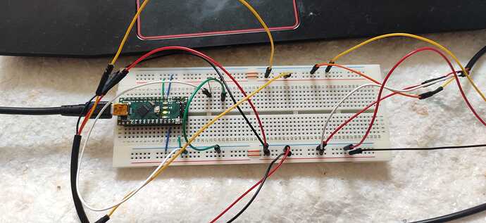

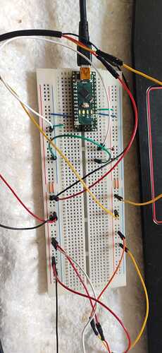

Hello all, I have task, to run 5 DS18b20 waterproof sensors providing the link ( https://de.rs-online.com/web/p/entwicklungstools-sensorik/2049893). so I have to run this sensor in Parasite mode, So my problem is , Those sensors are working fine with the Non Parasitic mode, on 3.3v and on 5v with pull-up resistor.
But when I am connecting VCC to ground (Parasite mode), I am always getting -127 dc according to datasheet sensors are disconnected, so I have spend lot of time on it, but I didn't find out what went wrong.
  1. I have solder each cable so that I can connect those to my breadboard(so maybe because of less metal solder).
  2. while testing I have made the wrong connection, so because of this sensors damaged
    3.Is it possible this DS18B20 sometimes doesn't work on parasitic since all are working fine in Non-parasitic
    4.I have tested this with 1k,3.3k,4.7k, and even with 10k, from internet solution. 5..So I did a lot of research, And now I am leaving hopes from it, I need guidance over it, I don't know what went wrong now, Is it possible I will contact through your mail or something so that I can share my hardware connections.
    I am attaching my results here, please kindly check
    , Thanks a lot for Your help

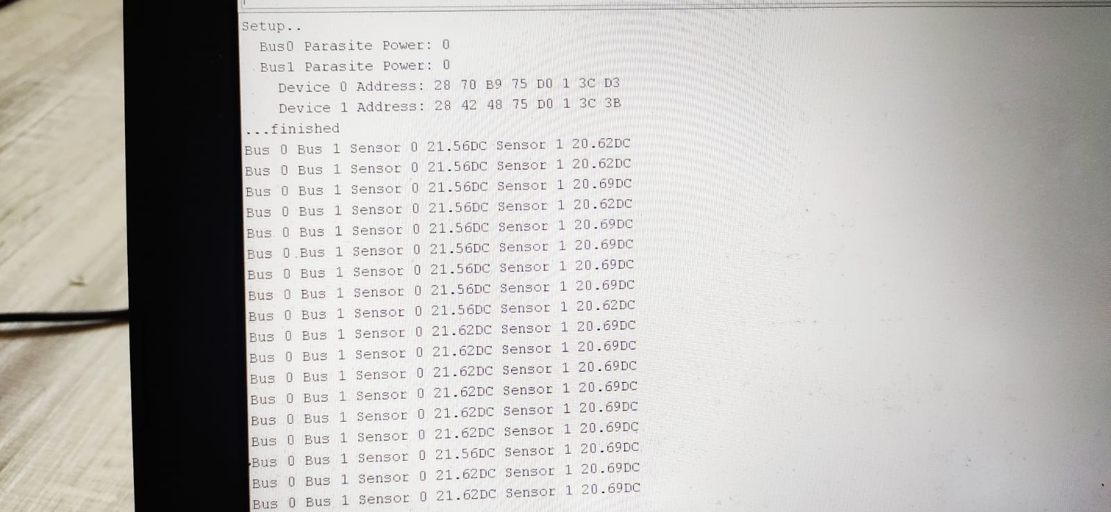

so In the pictures:
  1. I have used 2 buses connected with the parasite using a 4.7k pull-up resistor all sensors working well !
    result- sensors with non-parasite mode working fien|690x317
  2. Connected 2 sensors in parasitic and 2 in non-parasitic, here only 2 sensors are working wich is parasitic.
