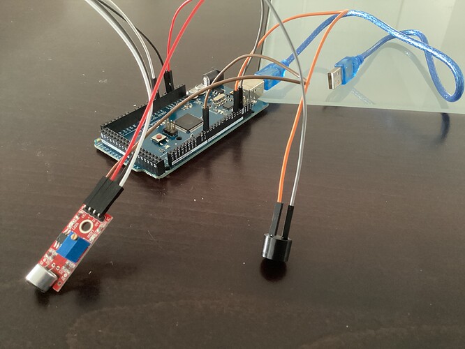

This is my first ever project, I’m trying to make a device that activates an active buzzer when 70db is reached using a sound level sensor, the equipment I have is ELEGOO the most complete starter kit. I need with everything, step by step instructions are appreciated alot. The project is due very soon.

I dont have a sketch but i have tested it irl.
I can also give u another photo if u need.
It would seem important to place the buzzer some distance away from the sound sensor to avoid a self sustaining loop. If the buzzer is active and consumes less than 20mA you can test it using the blink sketch (program) example in the Arduino development environment. A flyback diode is recommended. What sound level sensor can you use from that kit?

Mb mb I didn’t be clear, so my sound level module isn’t accurate,
This is my code
const int soundSensorPin = A0; // Sound sensor analog input pin
const int buzzerPin = 2; // Buzzer digital output pin
const int threshold = 70; // Sound level threshold in dB
pinMode(buzzerPin, OUTPUT);
int sensorValue = analogRead(soundSensorPin);
float voltage = sensorValue * (5.0 / 1024.0);
float dB = 20 * log10(voltage);
Serial.print("Sound Level (dB): ");
Serial.println(dB);
if (dB >= threshold) {
digitalWrite(buzzerPin, HIGH); // Turn on the buzzer
digitalWrite(buzzerPin, LOW); // Turn off the buzzer
delay(1000); // Adjust the delay as needed
And for some reason it shows me that somehow the noise level is 9db even tho its 50-60db with an actual sound meter, is that an issue on my side?
Also whenever I talk louder there seems to be no effect.
Specify "accurate".
It isn’t accurate in sound level
Check the data sheet of the sound sensor with respect to "Output voltage vs. dB(a)" in order to map the correct ratio in the program.
