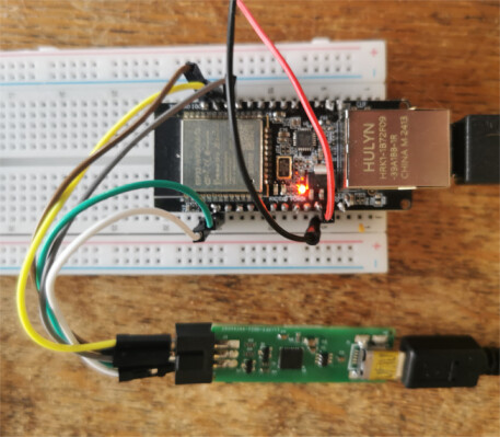

You have the board set to 'ESP32 Dev Module' in the IDE but which board do you actually have ?

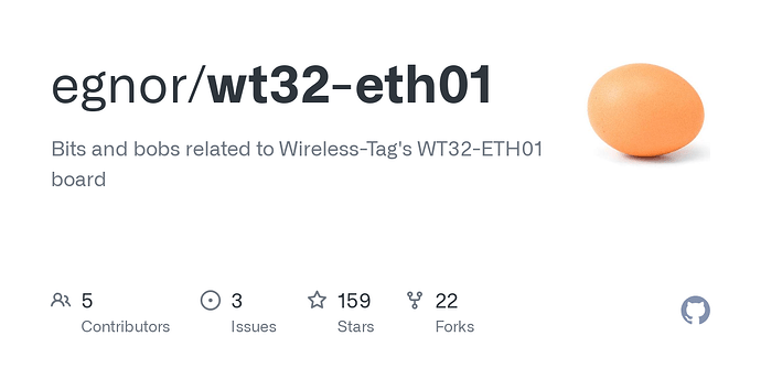

Can you please post a link to it ?
Thank you, this is the board I am using.
Hi @dnel923. The error is caused by a bug in the "WebServer_WT32_ETH01" library. Fortunately the fix for the bug is fairly simple. I'll provide instructions you can follow to fix it:

how do you program the device?
upload a photo of the setup?
Here it is. Is this what you mean?
thinking of a photo of the devices and connections, e.g.
HelloServer.code used for output shown in post 14
