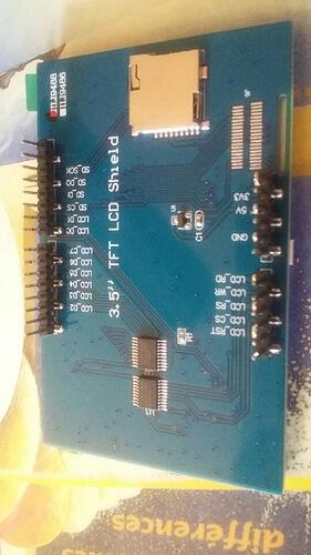

I am trying to use this display :
www.ebay.fr
Module couleur 3,5 pouces TFT 480x320 LCD Mega2560 bouclier avec/sans contact | eBay
But I do not use the Arduino world, the target is to make a handheld device to display ECG with an AD8232. So I don't use libraries, I expectwriting all in C for a Microchip PIC16 mid range.
I have bought several items, all in 8bits data bus, not SPI, for speed. The blue FR4 versions have 5v and 3v3 pins on connector, but 3v3 is not wired to AMS1117 reg. So I have shorted in and out to supply 3v3 via 5v pin. Even in whoel reset the screen is white, and a deffect for one which has two cyan zones !
I have not set pwm values, not driven display ON, so I expected it should be black. And the memory write for 5000 pixels is not visible.
May I have help ?
Best regards

By reading some posts about IL9486 I understand that when the chip does not receive commands the screen is completely , but the datasheet indicates register values after reset so I thought the backlight was off, this is not the case. And a hardware reset has no effect too.
I have also seen that it is not uniquely the 9486, the Chinese put different chips and with Ebay what a pity !
I am completely able to write fron a white sheet, if only I am sure of the chip, without reading the ID inside. I have ordered a few other screens but without certitude.
Alain
I have found some other displays in my stock, like this one
When I power it, it is white for a small time then black.
Another one (ILI9325) has similar working.
So I am wondering if displays that stay white have a broken controller ?
How can I interrogate the chip to know which one I have ?

Today received an other display :
The chip is indicated
