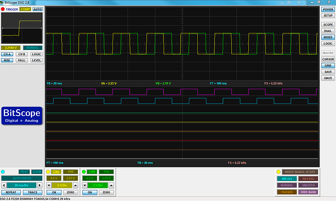

Hi Guys
Looks like the Z channel looks like it should.
Another issue i came across is to trigger the Z index channel only every 2500ppr
I`m not sure how to catch that on the scope but here is the code if somebody could have a look.
First code is triggering the Z channel with the counter but i cannot pickup that Z channel for some reason
The second code is without the "resolutionCount" so the Z trigers every cycle
Resolution count integer is Global
